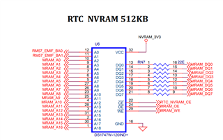

Connections I used
DS1747W-120IND+ Pin diagram

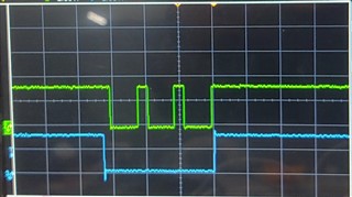

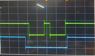

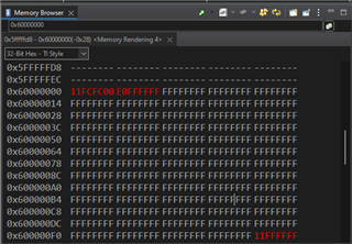

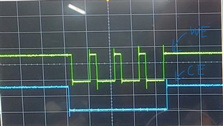

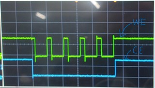

The Problem is While writing one byte of data in 0x60000000 location the next locations 0x60000001, 0x60000002, 0x60000003, 0x60000004 data also writted and I can't read or write  the RTC data.
Before one byte data write
After one byte data write
