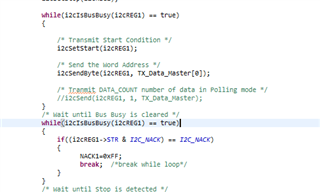

3. Please help to check following code. I want to use it to check if it can trigger an interrupt. Alas because it only send the i2c address and no data, there is no interrupt generated. To make matters worse, there is no stop bit generated. The routine hangs in the polling of stop bit. Thank you for your support.

    If you look at this code below, you will find that bus busy check comes after receive byte. How to check it before to prevent hanging in receive byte for non functioning device or i2c bus. I actually have a board whereby the i2c interrupts don't work at all. That is one case. Another case is if the device don't work. Hence I tried to use item 3 above whereby i make i2cSetCount(i2c, 0) . I set count =0 so I don't need to transmit or receive data. Just test the slave address.  But then the stop bit don't work after sending the slave addr. What do you recommend. Currently the software only work if my bus and devices work but hangs if either one don't work. The software should be able to detect the failure and not perform the i2c transaction for failed bus or device. Looking forward to your support. Thank you

    I don't think it would be required to check i2c busy bit before receiving a byte, it is because there won't be any multi masters on the bus right. I mean there is only a single master that initiates the start condition and sends the slave address so there won't be any possibility to get SET busy flag before receiving a byte.
    If you still want to check before sending start byte also then you can do something like below

    Thank you for your reply. I will see if your suggestion works for defective boards and ICs. Can I ask you about my code which I pasted above under item 3. I paste below again. Can you try this code on your side and see if it works for detecting any IC? I have used it on my side and find that there is no stop bit sent. Hence the code will fail at while loop for checking stop bit. Looking forward to your reply. Thank you

  • By the way, the while BB check which you recommend doesn't work to prevent the software from entering into i2c routines if the i2cbus is not working.
