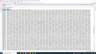

  • Dear Jagadish
    I am  happy to inform you that I manage to get sci4reg to work on my hardware.
    #define UART              sciREG4   /* port  for UART boot . Was sciREG1 */
    I can see the data flashed in the flash memory. Please see below. But my software don't run when it jumps to 0x20020
    g_ulTransferAddress = 0x20020;
    ((void (*)(void))g_ulTransferAddress)();
    How to compare the binary of flash memory and bin file? I saw that there is a utility for saving flash memory of ccs. I did try but the results are strange. Do you have user guide?
    Looking forward to your reply. Thank you
  • I can see the data flashed in the flash memory. Please see below. But my software don't run when it jumps to 0x20020
    What should your application software do?
    Does it involve any interrupts?
    Did you just test your application software without bootloader, by programming it at 0x0 address?
    Thanks & regards,
    Jagadish.
  • Dear Jagadish
    My application is to control some motors. We have spent the last 9 months developing it. It involves interrupts. We have been using ccs to debug our code. When clicking the debug button ( the beetle icon), it will auto load the .out file and go to main(). The binary file is generated using this tool cmd:
    "${CCS_INSTALL_ROOT}/utils/tiobj2bin/tiobj2bin.bat" "${BuildArtifactFileName}" "${BuildArtifactFileBaseName}.bin" "${CG_TOOL_ROOT}/bin/armofd.exe" "${CG_TOOL_ROOT}/bin/armhex.exe" "${CCS_INSTALL_ROOT}/utils/tiobj2bin/mkhex4bin.exe"
    I use the bootloader to flash the bin file to location 0x20020 .
    1. Theoretically it should work. But it didn't. We have some LED which will flash a number indicating the state of the motor. Normally it does but using bootloader loaded image, it doesn't. It also didn't respond to external switches.
    2. I would like to test the binary file (.bin) by loading it, instead of using the .out file. Can you tell me how to flash? I read from forum that there is a uniflash tool but don't know how to use it.
    Looking forward to your reply. Thank you.
  • This is the image when I run the bootloader.

  • Could there be a mistake in the definition? 0x002 0000 vs
    tried flashing to flash bank 1 which is at 0x20 0000 . It also doesn't work. So I don't know what to do. It looks like there is a need to put the new  application vector interrupt address in bootloader?
    Yes, it is not the mistake. It is intentional only. The application start address will be choose based on the size of the bootloader. On our code the bootloader is less than the 0x20000, so we choose the application start address 0x20000.
    My suggestion would be is, please try to provide application and your bootloader codes on private chat. Or at least try to create a simplest project with the issue then i will debug and will provide you workaround.

    I was looking at some codes on intvecs.asm . This is from something I saw in another project.
    #define DCU_APP_START_ADDRESS       0x002000A0
    How do you modify the jumps as shown above in the sample uart bootloader code which I got from you? Looking forward to your reply

    My application code which has 0x20 bytes of intervec data has the following code as seen from memory browser
    Below is the map file:

  • Hi LayEng,
    Thanks for providing your codes on private chat.
    I verified and found the below observation:
    The application code is starting from 0x00000020, if we program like this then this application will overwrite the bootloader code right?
    So, i changed the linker file of the application code you provided:
    After doing above modification in linker file, first i programmed the UART bootloader and then using that bootloader i sent the application binary through Hyper terminal and i observed now everything is working as expected.
    I am sending my tested projects to you over private chat, so please test them as it is and update me.
