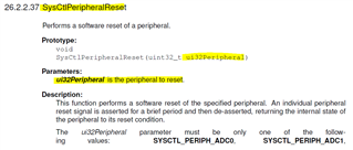

However, we've found that performing a software reset of the Tiva, by calling SysCtlReset(), does result in I2C communication on this channel to work again.
Is there some way to do what SysCtlReset() is doing, but only for a specific I2C channel?
  • Hi Terence,
      Please try SysCtlPeripheralReset().
  • Thank you .  We just tried SysCtlPeripheralReset(SYSCTL_PERIPH_I2C9) and no luck.  It did not have the same result as SysCtlReset().

  • Hi Terence,
    Question: After calling SysCtlPeripheralReset(SYSCTL_PERIPH_I2C9) should I reinitialize the I2C the same as I do at startup by calling SysCtlPeripheralEnable(), SysCtlPeripheralEnable(), GPIOPinConfigure(), MAP_I2CMasterInitExpClk(), etc or not?
    Yes, you need to reinitialize I2C but I'm not sure if this will fully resolve the problem if the slave is also in a hanging state. The reason is that the master has already lost synchronization with the slave for whatever reason. Earlier you mentioned, there could be some hardware issue. The slave could be in a unfinished (non-idle) state. For example, the slave may be expecting another clock from the master or it is expecting a STOP bit from the master. Therefore, not only you need to reinitialize the master but I think you should also reinitialize the slave to break it from a hanging state.

  • Hi Charles, thanks for the reply.  Reinitializing after calling SysCtlPeripheralReset() resulted in "fixing" the problem, or at least letting I2C communication continue.  Tho we still believe this is a hardware problem due to the fact that we've done SOOOOO much I2C communication the exactly same way with these same sensors on different boards and various other peripherals and never had this problem.
    Yes, the post you reference from a couple of years ago with Bob Crosby did cross my mind.  There are differences though: We were not seeing the I2C_MASTER_ERR_ARB_LOST error in this recent case.  Additionally, in this case the lines seem to be stuck high, which I didn't expect bit banging would fix.  I would expect bit banging to help in a case where the SDA was stuck low, but not stuck high like in this case.
