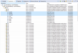

    For example:
    1. This is my primary control packet. Here i am trying to send 10 elements and 1 frame, that is why ITCOUNT register have 0x000A(elements) and 0x0001(Frames).

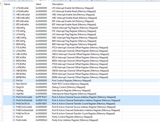

    2. This is the Port/FIFO registers after sending one character.
    Here you can see TrCnt register value as 0x0009(remaining elements) and 0x0001(remaining frames)
    3. This is the Port/FIFO registers after sending five characters.
    Here HBC interrupt triggered and also TrCnt register value as 0x0005(remaining elements) and 0x0001(remaining frames).
    4. This is the Port/FIFO registers after sending nine characters.
    TrCnt register value as 0x0001(remaining elements) and 0x0001(remaining frames).
    5. This is the Port/FIFO registers after sending ten characters.
    Now BTC flag also set, and TrCnt register value as 0x0000(remaining elements) and 0x0000(remaining frames).
    So, i would suggest you to use these registers for to know how many elements transferred by DMA instead of CDADDR register.
