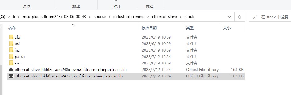

2.Upgrade the SDK version to mcu_plus_sdk_am243x_08_06_00_43:
    After recompiling SSC_V5i13, we get the new ethercat_slave_bkhfSsc.am243x_lp.r5f.ti-arm-clang.release.lib. Then, when I recompiled ethercat demo, I got this error.
makefile:163: recipe for target 'ethercat_slave_simple_demo_am243x-lp_r5fss0-0_freertos_ti-arm-clang.out' failed
 undefined           first referenced
  symbol                 in file
 SSC_DIAG_newMessage C:/ti/mcu_plus_sdk_am243x_08_06_00_43/source/commercial/industrial_comms_libs/ethercat_slave/ethercat_slave.am243x_lp.r5f.ti-arm-clang.release.lib<ecSlvApi_Diagnosis.c.obj>
error #10234-D: unresolved symbols remain
error #10010: errors encountered during linking; "ethercat_slave_simple_demo_am243x-lp_r5fss0-0_freertos_ti-arm-clang.out" not built
tiarmclang: error: tiarmlnk command failed with exit code 1 (use -v to see invocation)
gmake[1]: *** [ethercat_slave_simple_demo_am243x-lp_r5fss0-0_freertos_ti-arm-clang.out] Error 1
gmake: *** [all] Error 2
makefile:159: recipe for target 'all' failed
