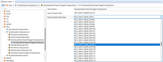

Autosar env arch understanding (as per MCU config options and RM diagrams) :
  • There is not configuration option seen in Port or MCU module to configure the INTrouter (GPIO_XBAR_INTRTR0) module
    • Would this mean that for GPIO interrupts the INT Router is not needed to be used; instead InputXBAR module needs to be used?
  • MCU module provides interface for mapping GPIO to XBAR_OUT
    • This mapping is not seeming to be routed to an interrupt, Rather seems to be mapping GPIO port to XBAR_OUT
  • On looking through the DIO and Port modules static files; we do not observe the <module>_Irq.c files that should handle the GPIO specific ISRs
    • Would this mean that the we would need to handle these GPIO interrupts as non-CAT2 ISRs (CAT0 or CAT1)?
