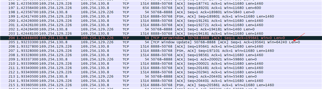

    Wireshark display:
    Code:
    How to improve transmission efficiency? The arrow points at: Sending only starts after an interval of 500ms

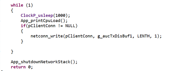

    test: 1000us sleep reduced to 500us / 800us and unable to establish connection

  •  Hi,
    1.ClockP_usleep(1000); Modify to
    ClockP_usleep(500); / ClockP_usleep(800);
    The client cannot connect to the server

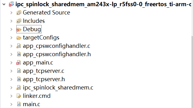

    a.R5F0_0:  freertos  ,Implement Ethernet transmission function  。ENET_ Cpsw_ The tcpserver program
    b.R5F0_1     nofreertos , Implement function on this project: form two send array(36K per array) when the send array is ready ,notify R5F0_0 freertos to send this array out over Ethernet tcpserver.
    c.Dual core Shared memory about 75K

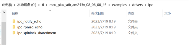

    Based on, ipc_spinlock_sharedmem 。How do I transplant ENET_ Cpsw_ The tcpserver program ?Or is there any other migration plan that can help me quickly establish this system Project.
  • Hi Haojie,
    You can use ipc_spinlock_sharedmem out-of-box example to get started as it already has FreeRTOS on R5F0_0 and NoRTOS on R5F0_1.
    Are you using CCS for development or gmake build system?
    Based on that I can guide you with the steps for migrating enet_cpsw_tcpserver to this example
    Shaunak

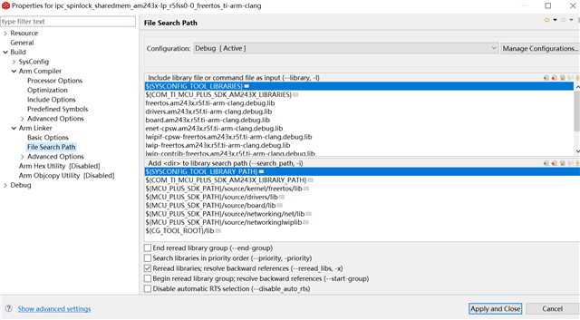

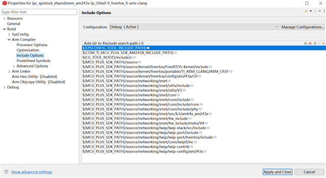

    Here is my IPC project,I may need to be based on :ipc_spinlock_sharedmem. I am using CCS,and I have already run through the ipc_spinlock_sharedmem. I need your guidance on my future migration  . Including the modification of Shared memory size
  • Hi Haojie,
    Listing down the steps below:
    1. Import the IPC spinlock sharedmem example in CCS workspace
    2. Add the C and header files present in the enet_cpsw_tcpserver example to your ipc_spinlock_sharedmem project.

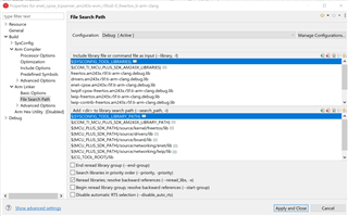

    3. Open project properties, make sure in ARM Compiler you have the enet and lwip include search paths, something similar to shown below.
    4. In ARM Linker, make sure the include library files and library search paths are configured correctly as well.
    5. Then rebuild the project
    Following the above steps, you will be able to integrate the enet_tcp_server in your ipc shared memory example.
    You can refer the makefile of enet_cpsw_tcpserver example to check the compiler and linker paths and add it as mentioned above.
    Please try it out and let me know if you face any problems.

  • 1.Please help me solve this problem first

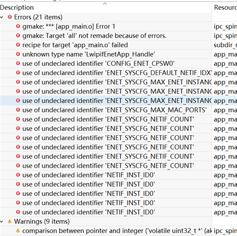

    2.Migration results
    Add relevant files
    rebuild the project
    The relevant files are empty。
    It should be  missing related configuration sysconfig
  • Hi Haojie,
    1. The issue here is that it is a delay while loop and not just a sleep for the TCP Server task, it will stop and consume the whole CPU performance, the OS tick is configured to have accuracy of 1ms or (1000us), so anything less than that would block the CPU and basically the TCP Server task thread would become blocked. Due to this, even if your TCP client tries to connect to the Server, since the Server task thread is blocked, it won't be able to accept the incoming connection. So, I recommend not changing the Sleep to less than 1000us as it is not the Server thread sleep but the whole CPU operation being put to hold.
    2. Yes, sorry i missed out on mentioning, you need to change the example.syscfg as well, for ENET_CPSW_TCPSERVER, you can refer the example.syscfg file of examples/networking/lwip/enet_cpsw_tcpserver/am243x-lp/rf5ss0-0_freertos/example.syscfg. You will have to add components such as CPSW accordingly in syscfg. Please follow the example's syscfg file and add the same configurations to your ipc shared mem example as well.
    Please just compare the example.syscfg files and add the modules accordingly, apologies for missing out on this point in my previous reply.
    Adding syscfg configurations and rebuilding should resolve the mentioned errors.

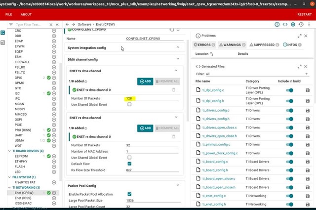

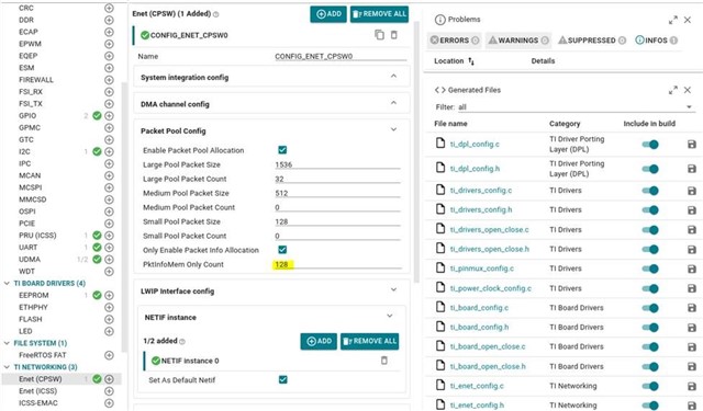

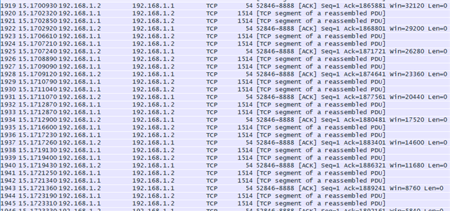

  • Hi Sirui,
      Would suggest the below changes in the application (example), syscfg GUI and  LwIP TCP/IP configuration.
    With this locally I am able to improve TCP Tx throughput numbers, ofcourse, by compromising on the memory footprints.
    1. Increase the pktInfoMem Only Count to 128 in syscfg GUI packet pool config
    1. Increase TX DMA descriptors-
    1. Configure TCP specific parameters as per the attached file ‘tcp_perf_patch.txt’.
      Changes are 'enet_cpsw_tcpserver' example, lwip_opts.h and lwip_pools.h files

    - You may refer to https://lwip.fandom.com/wiki/Maximizing_throughput and https://lwip.fandom.com/wiki/Tuning_TCP  to know more.
    1. Try to increase the TCP window length in the sscom5.11c software.
    2. Please modify the example ‘examples/networking/lwip/enet_cpsw_tcpserver’ as per suggestion in ‘tcp_perf_patch.txt’.
    3. Recompile the libraries:
      $ cd C:/ti/<mcu_plus_sdk>/
      $ gmake -s -j 4 DEVICE:=am243x PROFILE:=debug libs-clean
      $ gmake -s -j 4 DEVICE:=am243x PROFILE:=release libs-clean
    4. Recompile the example
    6. After this recompile the libraries and ‘examples/networking/lwip/enet_cpsw_tcpserver’ and run the example.
    Please note that the above changes are improves the transmission performance by compromising on memory. Let me know if it helps.
    With regards,
    Pradeep
