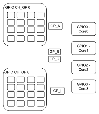

I have some confusions related to the mapping of the GPIO modules and groups. Based on the references from the RM here is my understanding.
  • There are 144 GPIO port pins available for IO processing. Each are interrupt capable
  • These 144 pins are grouped into 9 groups (A-I) as in the MCAL Port config. These groups are also referred to as Banks in the RM.
  • There are 4 GPIO modules GPIO0 - GPIO3
    • Each of the modules are mapped to the corresponding cores Core 0 - Core3
  • Each GPIO modules have configurations registers related to all 144 pins, as grouped in banks

    Are there 144 (pins) * 4 (GPIO modules) = 576 pin configurations possible?
    Technically, one can configure given physical GPIO pin for one GPIO bank. so at a time only one set of 144 configurations are possible.
    Which pins/groups/banks are mapped to which core?
    There are 144 GPIO Pins but only one core can drive per pin based on its PinMux configurations. so these 144 GPO pins are resources that can be configured for each core exclusively. but all GPI may be read at all 4 GPIO banks i.e., by all 4 cores.

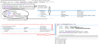

    I am currently working with the sdk example project 'gpio_input_interrupt_am263x-lp_r5fss0-0_nortos_ti-arm-clang'. And this is what I notice as per the code flow.
    Just to let you know that i am trying to make it work in the Autosar MCAL env. I notice that the PWM_Init takes care of BINTEN, PIN_DIR and PIN_TRIG regs. So, I have configured the CAT2 ISR for VIM intr 142
    But my ISR does not hit. I suppose that the missing link would be the INT router mapping/configuration. But I do not see this mapping from the SDK example that I have mentioned earlier.
    Do let me know what you think; that I am missing.
  • Ashish,
    Can you check the sysconfig generated code for the same example? There is a GPIO_XBAR_INTRTR configuration from this GPIO bank happening in the same example. Also, the example has been updated in the latest SDK (8.6).
  • Hi Madhava,
    I did check the generated code and configured the INTRTR module as well; I can now see that the GPIO_XBAR_INTR_MUXCNTL register is also updated as per the sample example.
    The sdk sample works fine. But in the Autosar environment; the ISR at the SW4 button press does not get triggered; if flashed after clearing all the registers. Strangely; what we also see is that if we flash the sdk example and then flash the Autosar SW (without clearing the register settings); the Autosar SW ISRs also get triggered.
    I have cross checked the GPIO0_BINTEN, GPIO0_DIR, GPIO0_SET_RIS_TRIG, GPIO0_CLR_RIS_TRIG, VIM_INTR_EN_SET_4 registers; and they look almost as per the values in the sdk example. I am a bit unclear if we would need to consider the VIM_PRIIRQ, VIM_IRQVEC registers as I see some differences but un able to interpret what is expected.
    Is there any other registers; that I will need to monitor. It would be grateful; if we could try to have a short debug call.

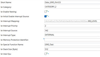

    For the INT configuration there are 2 steps:
    * Set the INTRTR setting to route the INT to the VIM -> This I have done by using the API from sdk, as the configuration option is not available for this in MCU
    * Configure the OSISR for GPIO interrupt (142), as CAT2 ISR
