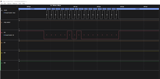

I have imported this into sysconfig, trying both in the uart uniflash, and the ospi_flash_io projects, in the ospi_flash_io, there is a memory read mismatch, and in the uniflash, the flash open fails. I have put the protocol into 1-1-4 as required in the datasheet for qspi flash, and put the following configuration in the sysconfig:
 ( I have tried without and with the TI quirks function)
I have only the first 4 ospi data lines enabled. What do I need to do to use the qpsi_nor_flash files, as it still seems to be using the driver for ospi? What am I doing wrong? Can you give me any direction/help please?

    I see some mismatches between the JSON data generated by the flash diag and the configuration you're showing in SysConfig. Did you do any manual updates? I am specifically interested in the QE Type. I see that you have it updated in the sysconfig as 3. Did you get that data from the flash datasheet? Because if the QE type is incorrect, 1-1-4 mode won't be enabled correctly. Let me get back to you after checking the flash datasheet.

  • Yes I did try some manual changes after the first import didn't work. I was looking at the datasheet, but I was not sure about that one and the QPI Sequence. I have tried both with the exact after uploaded, and a handful of other variations.

    After going through the datasheet, what I can see is that the quad enable requirements are zeroed out, which means that it might be enabled by default or detects based on instruction. In this case you should set the QE type as 0 itself. This is for 1-1-4 mode. Let me know if the configuration worked.

  • Hello, I can confirm that that did not resolve the issue. Is there anything else you can think of?

  • Hi Jacob,
    Can you let me know what is the data mismatch? Is it data missing, or data shifted by some bytes or something else? If you can post the values of the Rx and Tx buffers in the example after the transfers before the comparison, that would be helpful. Because it is possible that there is a timing issue here. That can be adjusted with dummy cycles and read capture delay settings.
    Anand Mahadevan SS
  • For the first write to flash, the tx buffer counts up from 0 to 255 and repeats. This is the rx_buffer after the first read attempt:
    The read buffer has the same contents after the second read as well.
    I tried turning off DMA to see if that made a difference, and it did not.
    Changing the read busy mode from Legacy to the SR bit 7 also did nothing.
    Changing the timing to the following:
    Resulted in contents:
  • Update: I got the flash IO to pass with setting the write command to 0x32 and dummy cycles to 8, but the bootloader (running uart_uniflash) still doesn't work
  • Update, got qspi flash to work. will post solution tomorrow
    edit: Flash now opens, and in the flash_io example, it passes, but only without any ddr configured. The uart uniflash fails if ddr is not configured (the entire image after uniflash gets sent, but 100 percent, there is a getchar timeout) and if the ddr is configured the ospi flash does not open.

  • Hello, in reply to what we talked about in the call, I will provide scoped data, clock and cs lines for the dummy cycle write. I will not be able to before tomorrow, as I need to coordinate with the hardware developers.
  • I have captured files that can be used to see what the spi lines and clock and chip select are. This happens when running the ospi_flash_io project, configured for qspi as we had talked about over the phone. When DDR is configured, we couldn't figure out what command it's trying to do. It should be doing a read of the vendor ID, that's 0x9F command without ddr config. But instead it's doing 0x30 which is not a valid command and not driving chip select.
    No DDR Config, first few transactions. First transaction is with 6.25MHz clock and then changes to 50MHz clock
    With ddr config enabled, we just see clock and D0 line toggling. This keeps repeating non-stop. Starts at 50MHz clock immediately.
    I have emailed you the files that have these captures. They can be analyzed using software from here:
     Logic analyzer software from Saleae
    T
    his seems like a bug on the TI side of things, for whatever reason having the DDR configured makes QSPI open fail.  Please take a look and get back to me. My last day at my company is Friday, and I am hoping to have some resolution to this before then. Thank you for your help
  • Also just a note that UART Uniflash over ospi (with ddr configured) works fine.

  • I believe I identified the root of the issue for why you cannot read the QSPI flash. During init_DDR, a function enables VTT; the pin used for this is CS1. But we can skip this function since VTT is not needed for LPDDR. Here is my modified DDR.c file, please use this in your build as we implement a fix for the next SDK. The line I modified is 450-454. Can you test this and follow up on your results?
