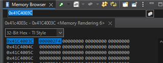

I am trying to use the Temperature sensor function on the evaluation board.

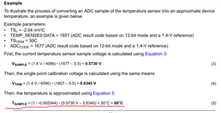

I am trying to calculate with the contents of the technical manual 2.2.5 Temperature sensor.
However, the value of TEMP_SENSE0.DATA is 756, not 1857, which is described in the example, and the calculation does not work well.
The address is looking at 0x41C4003C.
