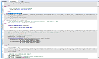

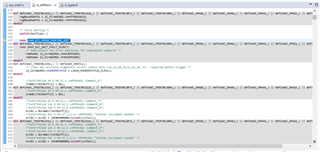

For the TMS570LC, when this bit ECC_WR_EN in the RAMCTL is set to '1'. which allow the ECC region to be writeable refer to TRM pg394
I tried to perform the following. In my program, the specific ram variable is at address 0x08001500 and the corresponding ECC would be at 0x08401500.
At the begin of my test, I have observed that the ECC upon start up is 0x0c0c0c0c0c0c0c0c.
1) Can I open up the memory browser and corrupt the ECC content?
2) Instead of using the memory browser, I can write some test code to update the ram variable, corrupt its corresponding ECC and read the ram variable back?
Do you think my tests procedure are correct? I have observed that the ECC is always stay at 0x0c0c0c0c0c0c0c0c, and no errors are detected.
