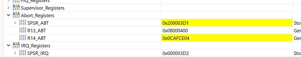

I’m currently implementing the safety library  v2.4 for the TMS570LS3137 and I’m experiencing a prefetch abort that does not happen when the debugger reset the board but is seen after a power cycle.
I can see the SW in the prefectch abort function when loading symbols with the debugger after the power cycle.
Some people seem to get similar issue but no thread actually shows a conclusion to the problem.
See below the capture of the abort registers. Abort instruction address seems to be in a reserved space. Will dig into that further further decoding the abort registers.
 In the meantime, any pointers woudl be highly appreciated.

  • Hi
    I managed to isolate the line where it happens  in syst_startup.c
    Just before enabling the interrupt we can see that FIQ channel 0 pending and IRQ Channel 21:
    FIQ Will be prioritized but FIQVecReg is loaded with an invalid address:
    IRQVecReg is loaded with with the address VIM Parity error handler:
    In the VIM, both ESM High and Low are enabled.
    ESM High is hardwired to channel 0 as FIQ.
    The VIM Parity register shows a parity error even is disabled :
    When enabling interrupts, CPU branches into address in FIQVecReg going to exception with abort registers showing and address close to the branch address in FIQVecReg:
    Now why I get a spurious address in FIQVecReg …
    It happens during the VIM parity check in sys_startup.c
    We have the VIM parity registers going as with FbParErr used to point to the parity error handler taking the address 0xC83CE02 shown during the abort:
    Interrupt registers now showing FIQ As pending and FIQRegVec showing the erroneous address:
    CRC Calc on VIM RAM creates a parity error on the VIM After parity check being enabled line #1269
    Partial solution found - Introduce a call to vimInit before parity checks on peripheral RAM. This to ensure that FIQRegVec gets a correct value in before any FIQ can be triggered by a parity check.
    This is resolved the prefetch abort but now stuck into an esm low interrupt with the VIM parity - seems interrupt is never cleared as Parity error handler is never called ...
    I was looking into the demo project for the safe library and I might have missed sonethign. I triple checked though but can't find anythiung really diffrent.
    Could you please let me know if I'm implementing the safety library the coirrect way or if I missed something ?
    Seb

  • Hi Seb,
    The SRAM address parity selftest will generate parity error, then ESM high priority interrupt. Once the VIM receives an interrupt (FIQ or IRQ), it loads the address of ISR from interrupt vector table (VIM RAM), and store it into the interrupt vector register (IRQVECREG for IRQ interrupt, FIQVECREG for FIQ interrupt). In the sys_startup file, the VIM RAM has not been initialized when performing the SRAM parity self test, so the FIQVECREG loaded an invalid address, and fectching instruction from this invalid address generate a prefetch abort.
    My recommendation is to use the polling mode for parity self-test and SRAM self-test. If interrupt is required by your application, please program the VIM table before doing the selftest.
    Before enabling interrupts, the application software must initiate the interrupt vector table (VIM RAM) pointing to the ISR for each interrupt channel.
