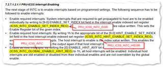

Example 1) In this TRM screenshot, the highlighted registers do not exist in the RA. The red items are, I think, the proper register name as mentioned in the RA. Regardless, none of the terms appear in the register list (AM263x.xml) in the debugger.

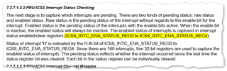

Example 2) In this TRM screenshot, I cannot find an equivalent register name in the RA nor an entry in the register list.
At the moment, we cannot reasonably debug the interrupt controller and work is stalled. We are prepared to use the Memory Browser to monitor registers from the RA address information but I think it's a tall order to monitor registers we cannot find in the RA nor register database.
I'm happy to be shown that I've misunderstood the documents (?) but, assuming I'm correct, please promptly provide updated RA documentation as a minimum. New registers databases will be very helpful and a new TRM will be ideal.
  • Hello Kier,
    You are correct about the discrepancy between the TRM and RA register naming. This is due to the documents being sourced from different areas and I will update them to be the same for the next TRM release.
    In the short term, could you please list all registers of interest and I will map them to the corresponding register in the Register Addendum.
    Erik
