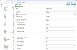

I am using AM64x MCU+ SDK 08.06.00.45 and attempting to support a new flash device in the sbl_uart_uniflash example.
I have successfully run the ospi_flash_diag example and have saved the JSON output to a .json file (SFDP is supported by my device). Here is the content of that .json in case it helps:
        "flashSize": 67108864,
        "flashPageSize": 256,
        "flashManfId": "0x2C",
        "flashDeviceId": "0x5B1A",
        "flashBlockSize": 131072,
        "flashSectorSize": 4096,
        "cmdBlockErase3B": "0xD8",
        "cmdBlockErase4B": "0xDC",
        "cmdSectorErase3B": "0x20",
        "cmdSectorErase4B": "0x21",
        "protos": {
                "p111": {
                        "isDtr": false,
                        "cmdRd": "0x03",
                        "cmdWr": "0x02",
                        "modeClksCmd": 0,
                        "modeClksRd": 0,
                        "dummyClksCmd": 0,
                        "dummyClksRd": 0,
                        "enableType": "0",
                        "enableSeq": "0x00",
                        "dummyCfg": null,
                        "protoCfg": null,
                        "strDtrCfg": null
                "p112": null,
                "p114": null,
                "p118": {
                        "isDtr": false,
                        "cmdRd": "0x7C",
                        "cmdWr": "0x84",
                        "modeClksCmd": 0,
                        "modeClksRd": 0,
                        "dummyClksCmd": 0,
                        "dummyClksRd": 0,
                        "enableType": "255",
                        "dummyCfg": null,
                        "protoCfg": null,
                        "strDtrCfg": null
                "p444s": null,
                "p444d": null,
                "p888s": null,
                "p888d": null,
                "pCustom": {
                        "fxn": null
        "addrByteSupport": "1",
        "fourByteAddrEnSeq": "0x36",
        "cmdExtType": "NONE",
        "resetType": "0x30",
        "deviceBusyType": "0",
        "cmdWren": "0x06",
        "cmdRdsr": "0x05",
        "srWip":  0,
        "srWel":  0,
        "cmdChipErase": "0xC7",
        "rdIdSettings": {
                "cmd": "0x9F",
                "numBytes": 5,
                "dummy4": 0,
                "dummy8": 0
        "xspiWipRdCmd": "0x00",
        "xspiWipReg": "0x00000000",
        "xspiWipBit": 0,
        "flashDeviceBusyTimeout": 128000000,
        "flashPageProgTimeout": 120

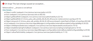

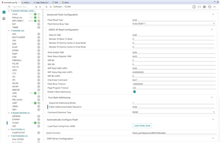

When I attempt to update my Flash parameters using this .json file in Sysconfig, via the "LOAD FROM JSON" button, I get the following:
Are there any suggested fixes for this issue?
Details on my CCS setup:
I would just manually enter the JSON parameters into Sysconfig but I'm not having success matching all of the outputs of the ospi_flash_diag example to the fields in Sysconfig (some are easy but others are not obvious).
Thank you very much
  • Greetings Vaibhav,
    Thanks for the reply.
    The fix mentioned in https://e2e.ti.com/support/microcontrollers/arm-based-microcontrollers-group/arm-based-microcontrollers/f/arm-based-microcontrollers-forum/1158269/mcu-plus-sdk-am243x-sysconfig---flash-ospi-qspi-option-missing-in-sdk-08-04/4357577#4357577 doesn't seem to be applicable to Code Composer Studio v12.1.0.00007 (also, many of the attached images and linked resources are no longer visible in that thread, would that be fixable?).
    Here is my flash_v0.syscfg.js file:

    line 7 doesn't pertain to any 'copy' command. The copyScriptPath variable starting at line 824 seems to indicate the copy command is related to copyutil.js... looking at copyutil.js, its not obvious where I need to change a "copy" to a "cp"...
    I can confirm that the cp.exe located at C:\ti\ccs1210\ccs\utils\cygwin works properly on my windows machine.
    Would you have any more advice fixing this issue?
  • Hi True,
    The problem is with the function system.getNodePath() called in the getNodePath() function located at <MCU+SDK install path>source\.meta\common.syscfg.js.
    Please remove the function call and change the code to return absolute path of Node js. The button will than work fine. Let me know if this solution works for you.

  • Thanks. This got the Load From Jason Button to "work" but it seems that the resulting sbl_uart_uniflash.tiimage doesn't work properly. I don't think this feature properly loads and/or sets all the settings from the json.
    I'll keep playing with it.
