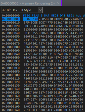

When tested in OSPI boot mode, exit after each test and then press normal debug without entering, you must re-program the bootloader before you can do so. Finally, it was successfully entered using load_DMSC.js mode, but it was found that the 0x60000000 locations of OSPI-Flash all changed to "E".

Normally, there should be boot data, as follows:
    load_dmsc is not responsible for initialization of the OSPI or the flash. The application loaded via JTAG (if it requires flash) needs to perform the initialization.
    Can you try loading ospi_flash_dma or ospi_flash_io examples ? If these examples tests fails, then we can debug what went wrong in the setup, else it justifies the flow mentioned above.
