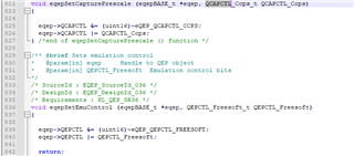

  • Hi Luis,
    Apologies for the delay in the response.
    - should the configuration of any used eqep control register (clear/set bits) only be done in one go?
    No, not necessarily. You can do it in multiple steps as well.
    As you can see the above code is the driver example code in HALCoGen, you can see there are API's to change the control register bits during run time as well.
    - control register bits not used should be explicitly sets to the reset values documented in the reference manual?
    No, not necessary to reset the values. You can just even ignore if you are not using the corresponding bits.
    - we want to reset of QCTMR on every position event.The Current configuration code for the capture timer sets the memory mapped register QCAPCTL bits in the following sequential order :
    1. Write 1 to bit QCAPCTL[15] (enable capture unit)
    2. Write 0 to bits QCAPCTL[5..6] (= CAPCLK = VCLK4/2)
    3. Write 1 to bit QCAPCTL[4] (= CAPCLK = VCLK4/2)
    4. Write 0 to bits QCAPCTL[0..3] (= UPEVNT = QCLK/1)
    My suggested flow is below:
    1. Disable the capture:
    2. Now set the pre-scalers as per the requirement:
    3. Enable the capture:
    Thanks & regards,
    Jagadish.
