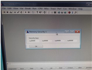

SM470R1B1M-HT: Customer has some issue on this device that Memory Security locked can't unlock.
Part Number: SM470R1B1M-HT
Hi teams,
My customer has 2 issues here.  Can you give me some suggestions? thanks
1 Memory Security is locked and can't unlock.
2. Can not find IC.

  • Hi Charles,
    Sorry for the confused.
    To my first answer: Every device is all new that this window message will appear if it is the faulty IC. Change new one will solve the problem.
     Do you have other boards to try?  Some board is normal. fail rate is  12/29
     Do you have at least one board that is working? yes
     Do you have EVM board to try out? NO

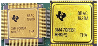

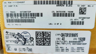

      Can you provide the device marking with LTC for all the failed devices?
  • Hi Charle,
    The customer found the issue again. The device is locked 2 pcs and can not find device through sofware 1 pcs.
    Lot No.
    0000930MTT
    9009955MTT
  • HI Jimmy,
      I suppose these devices are purchased from Arrow. Is that correct? I will check internally if the corresponding LTC has any abnormality.
  • Hi Charles,
    yes. from Arrow.

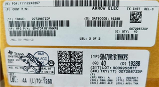

  • The customer found the issue again. The device is locked 2 pcs and can not find device through sofware 1 pcs.
    Lot No.
    0000930MTT
    9009955MTT
    Hi Jimmy,
      Can you tell me where do you find the lot numbers. Do you have a copy of the document that shows the lot info?
  • Hi Charles,
    From customer label info.

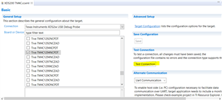

    Thanks for the feedback. At the moment, I'm out of ideas. As to the JTAG scan chain test, can you contact Lauterbach if such test is possible? Below is what can be done in CCS IDE if you are familiar with CCS. I wonder if an equivalent test is available in Lauterbach.
    Here is an example scan test output log using a XDS200 debug probe to connect to a MCU device.
    [Start: Texas Instruments XDS2xx USB Debug Probe_0]
    Execute the command:
    %ccs_base%/common/uscif/dbgjtag -f %boarddatafile% -rv -o -S integrity

    [End: Texas Instruments XDS2xx USB Debug Probe_0]
