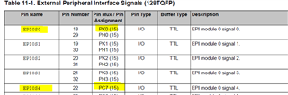

TM4C1290NCPDT: I do not see the EPI data or address line toggle. Where did it go wrong?
Part Number: TM4C1290NCPDT
With the EPI peripheral setup as follows:

	GPIOPinConfigure(GPIO_PK0_EPI0S0); // PK0 18 / PH0 29  D0
	GPIOPinConfigure(GPIO_PK1_EPI0S1); // PK1 19 / PH1 30  D1
	GPIOPinConfigure(GPIO_PK2_EPI0S2); // PK2 20 / PH2 31  D2
	GPIOPinConfigure(GPIO_PK3_EPI0S3); // PK3 21 / PH3 32  D3
	GPIOPinConfigure(GPIO_PK7_EPI0S24); // PK7 59   A8
	GPIOPinConfigure(GPIO_PK6_EPI0S25); // PK6 60   A9
	GPIOPinConfigure(GPIO_PK5_EPI0S31); // PK5 61 CLK
	GPIOPinTypeEPI(GPIO_PORTK_BASE, EPI_PORTK_PINS);
	GPIOPinConfigure(GPIO_PC7_EPI0S4); // PC7 22 D4
	GPIOPinConfigure(GPIO_PC6_EPI0S5); // PC6 23 D5
	GPIOPinConfigure(GPIO_PC5_EPI0S6); // PC5 24 D6
	GPIOPinConfigure(GPIO_PC4_EPI0S7); // PC4 25 D7
	GPIOPinTypeEPI(GPIO_PORTC_BASE, EPI_PORTC_PINS);

I can see that the clock is output properly at 30.72Mhz. With the following test program:
int
main(void)
    volatile int32_t ui32Loop;
    // Make sure the main oscillator is enabled. The system must have a 25MHz crystal attached to the OSC
    // pins. The SYSCTL_MOSC_HIGHFREQ parameter is used when the crystal
    // frequency is 10MHz or higher. SYSCTL_MOSC_SESRC for single ended osc iput (no crystal)
    #if 1// CLK_EX
    SysCtlMOSCConfigSet(SYSCTL_MOSC_HIGHFREQ|SYSCTL_MOSC_SESRC  | SYSCTL_MOSC_PWR_DIS);
    SysCtlClockOutConfig(SYSCTL_CLKOUT_MOSC | SYSCTL_CLKOUT_DIS , 1);
    //SysCtlClockOutConfig(SYSCTL_CLKOUT_MOSC, 1);
    //SysCtlClockFreqSet(SYSCTL_OSC_MAIN | SYSCTL_USE_OSC , 30720000);
    SysCtlClockFreqSet((SYSCTL_XTAL_25MHZ | SYSCTL_OSC_MAIN | SYSCTL_USE_OSC), 25000000);
    //HWREG(SYSCTL_RSCLKCFG_R)=0x03300000;
    #elif 0
    #else // internal with pll
    SysCtlClockOutConfig(SYSCTL_DIVSCLK_EN | SYSCTL_DIVSCLK_SRC_PIOSC, 1);
    SysCtlClockFreqSet(SYSCTL_OSC_INT | SYSCTL_USE_PLL | SYSCTL_CFG_VCO_240, 30720000);
    #endif
    PinoutSet();
    // Enable the GPIO port that is used for the on-board LED.
    SYSCTL_RCGCGPIO_R = SYSCTL_RCGCGPIO_R12;
    // Do a dummy read to insert a few cycles after enabling the peripheral.
    ui32Loop = SYSCTL_RCGCGPIO_R;
    // Enable the GPIO pin for the LED (PN0).  Set the direction as output, and
    // enable the GPIO pin for digital function.
    GPIO_PORTN_DIR_R = 0x01;
    GPIO_PORTN_DEN_R = 0x01;
    // Loop forever.
    while(1)
        volatile uint16_t *paddr=(uint16_t *)0xc0000010;
        volatile readval=0;
        // Turn on the LED.
        GPIO_PORTN_DATA_R |= 0x01;
        *paddr=5;
        readval=*paddr;
        // Delay for a bit.
        int delay=200000; //200000
        for(ui32Loop = delay; ui32Loop > 0; ui32Loop--)
        // Turn off the LED.
        GPIO_PORTN_DATA_R &= ~(0x01);
        *paddr=0x0a;
        readval=*paddr;
        // Delay for a bit.
I can see the /RD and /WR lines toggle properly, but do not see d0 or a4 toggle. Where did I go wrong?
