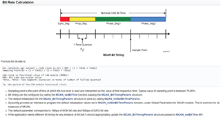

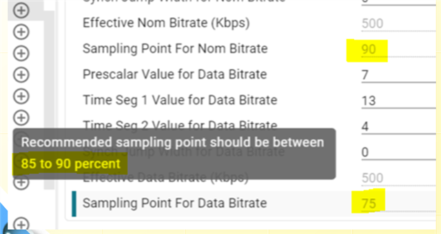

      I want to set 500k baud-rate of standard frame format CAN.Could you show me how to do it.

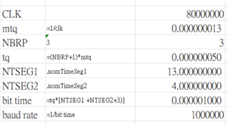

      I can set 1M baud-rate of standard frame format CAN

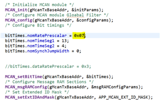

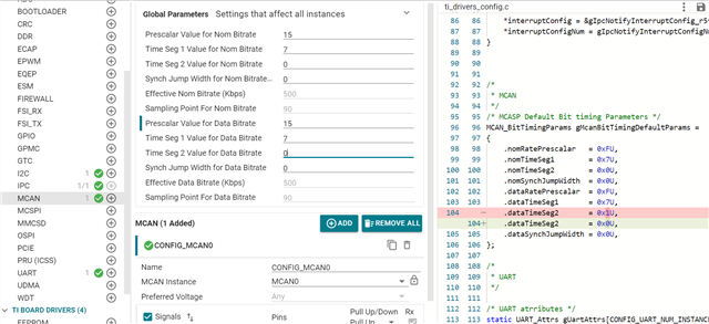

      Setting below bitTime parameter could get 1M baud-rate of standard frame format CAN .

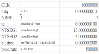

Changing nomRatePrescalar from 0x03 to 0x07 for  500k bit-rate of standard frame format CAN as below picture but baud mismatch.
Could you show 500 kbps's parameter for baud-rate of standard frame format CAN  to me.
