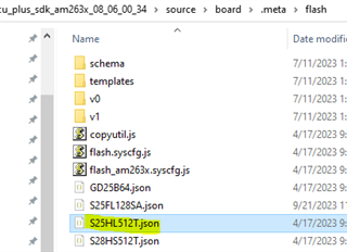

Hi Panda,
Please refer to below developer note. You can load the JSON file or type the flash parameters from the .json file manually.
The json file for S25HL512T Flashs is located in C:\ti\mcu_plus_sdk_am263x_08_06_00_34\source\board\.meta\flash

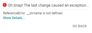

Hi Panda,
I just did a test of loading json file to sysconfig, but I got an error.
This is a known bug in SDK 8.06. Please add the flash parameters manually.
