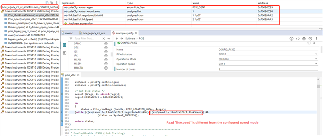

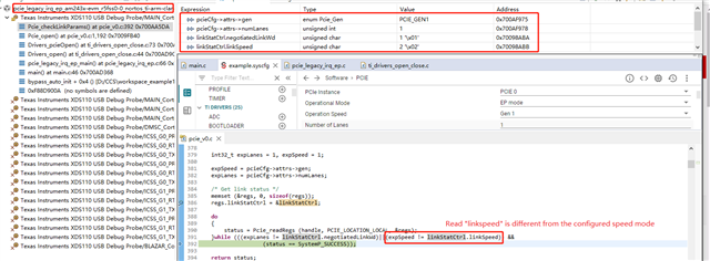

The PCIE legacy_irq can work in GEN2 mode, but it can't wok in GEN1.
