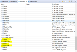

      Can you observe the registers for AES and DES to see if they are enabled and initialized.
  • Hi Charles,
    It shows 'unable to read.

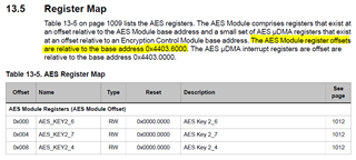

      Just to be sure, please go to 0x44036000 on the memory browser window. Do you see any initialization of any registers? Below is an example screenshot when running a simple TivaWare AES example.
  • Hi Charles,
    While looking at the location you mentioned, no initialization has occurred.

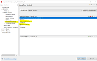

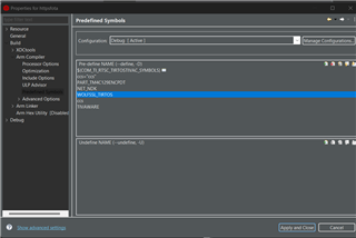

    The settings I configured for the wolfSSL library are as follows,
      I wonder if you have predefined WOLFSSL_TIRTOS and the corresponding MCU part number when you build your HTTPS project.
    I want to also give you a heads-up. I will be vacation starting tomorrow for a week. Please expect delay in my response.
    These settings were suggested by wolfSSL support, and they are presented in the predefined section.

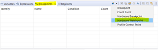

     Your screenshot looks fine with me but I don't know what is wrong; the -103 error message. Since I'm not an expert in the security layer, I will suggest you single step the TLS_Params_init() and TLS_create() functions and compare between using software encryption vs hardware encryption. Do you see where the difference might be? Another thing I can think of is to setup a watchpoint looking for any reads and writes to the AES and DES modules. This will tell us if the hardware accelerator is ever used by the WolfSSL library. AES module starts at 0x44036000 and DES module starts at 0x44038000. If the WolfSSL library or the HTTPS application needs to use the AES/DES, it must have tried to write to these these module registers in order to initialize the module.
