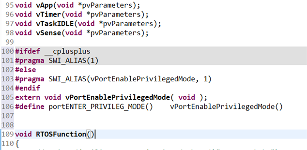

    The purpose of a bootloader is to update the firmware located in the flash. After the firmware is updated, a software reset should be issued, so the code execution will jump to the new firmware properly. My suggestion is not to use freeRTOS for bootloader.
  • The F021 Flash APIs must be run in a priviledged mode (a mode other than user mode) to allow access to the Flash memory controller registers. The tasks in freeRTOS is configured as user mode by default. You need to switch to a privileged mode before starting the bootloader, then switch it back to user mode after the firmware has been programmed to flash.
    void vTask_bootloader(void *pvParameters)
         portENTER_PRIVILEG_MODE();
         bootloader code ...
         portSWITCH_TO_USER_MODE();
         for(;;)   {
              vTaskDelay(1000);
    The Software interrupt handler is defined in os_portasm.asm
    You can add the following code to your includes.c file:

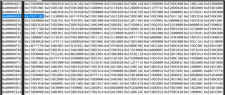

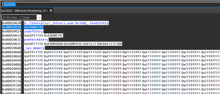

    I did the following steps:
    1 - Erase the total Flash (with UnityFlash)
    2- Load the Bootloader program (called UPGRADE2)
    3- With the target connected, I load the Application (at the 0x20020 position) (No erase Flash, so there is the Bootloader program at the beginning of the memory).
    This is the sys_link.cmd of the Application program:
    VECTORS (X) : origin=0x00020020 length=0x00000020
    FLASH_CODE (RX) : origin=0x00020040 length=0x008000-0x40 fill=0xFFFFFFFF
    FLASH0 (RX) : origin=0x00028000 length=0x0014FFC0
    FLASH1 (RX) : origin=0x00180000 length=0x00180000
    STACKS (RW) : origin=0x08000000 length=0x00000800
    KRAM (RW) : origin=0x08000800 length=0x00000800
    RAM (RW) : origin=(0x08000800+0x00000800) length=(0x0003F800 - 0x00000800)
    So, at the beginning of the memory there is the Bootloader program, and a the 0x20020 it's the Application program
    4- Did click on 'RUN', and the CCS starts to run the Application program, but it is blocked (or anything similar). Because I didn't see that the tasks were running.
    5- Did click on 'Pause', and I saw the following message:
    0x00004E44 (no symbols are defined)
    But in that position there is information
    6- I set a while(1) in the sys_main.c on my Application program (before the RTOS Scheduler), and I did the same steps again. And works (I see the LEDs power ON).
    But the issue is when I want to run the RTOSFunctions (where the FreeRTOS should start to run).

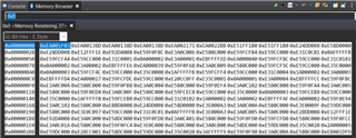

    7- In order to make sure that the Application works, I load the App only (in the 0x0 position), and works. For this, I changed the sys_link.cmd with the following lines and executed it:
    VECTORS (X) : origin=0x00000000 length=0x00000020
    KERNEL (RX) : origin=0x00000020 length=0x00008000
    FLASH0 (RX) : origin=0x00008020 length=0x00177FE0
    I am not sure about how to solve this issue. It's some strange. I really appreciate it if you could make anything suggestions about it.

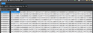

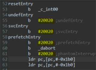

  • 5- Did click on 'Pause', and I saw the following message:
    Your bootloader is located at 0x00000000, and your application is programmed to the flash starting from 0x20020. The address 0x4E44 is not part of your application. It might be abort handler of your bootloader.
    The bootloader has small size, and it is hard to make it bug-free. Please modify the sys_intvecs.asm of bootloader to jump to your abort handler in your application in case there is a data abort.
    resetEntry
    b _c_int00
    undefEntry
    b #0x20020 ;undefEntry
    svcEntry
    b #0x20020 ;svcEntry
    prefetchEntry
    b #0x20020 ;prefetchEntry
    b #0x20020 ;;_dabort
    b #0x20020  ;;phantomInterrupt
    ldr pc,[pc,#-0x1b0]
    ldr pc,[pc,#-0x1b0]
  • Hello QJ Wang. Thank you for your fast reply.
    I performed your suggestion, but when I loaded the Bootloader, the board stayed with the Res Led On.
    If I don't change the _dabort, I can load the Bootloader, but I have the same result as before Disappointed
    Could it be strange, that once you started running the application at position 20020, it has to go back to previous positions? Since the error continues to be marked at position 0x00004E44.
    Thank you very much for your help
  • the board stayed with the Res Led On
    In your bootloader, do you perform any selftest which generates data abort intentionally? For example 2-bit ECC error forcing test. You can use polling mode in bootloader to check the error flag and clear the error flag manually in your bootloader.
    The 20020 in your sys_intvecs.asm should be in hexadecimal format 0x20020

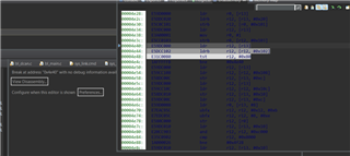

    I checked the step-by-step with another Application program, it has only 2 tasks and turns on and off 2 LEDs, and the results it's the same as before.
    The issue is when the App program is creating the tasks. In this point, I don't know why but jump to another position (at the beginning) when entering this line:
    xTaskCreate(vTaskIDLE, "IDLE", configMINIMAL_STACK_SIZE, 0, 1, &xTask1Handle);
    (I commented the rest of the tasks, but the issue is the same with everywhere FreeRTOS program).
    And the program jumps to these lines:
    Break at address "0x10" with no debug information available, or outside of program code.
    Break at address "0x85e8" with no debug information available, or outside of program code.
    Break at address "0x85dc" with no debug information available, or outside of program code.
    And there is info in these positions.

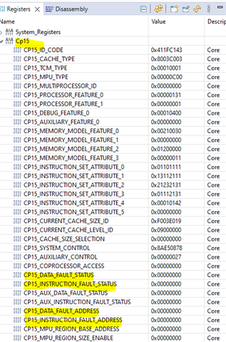

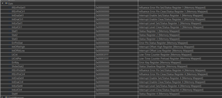

    My understanding is that you need the freeRTOS for your application, but not for bootloader. You don't use RTOS for bootloader.
    It looks like the 2 red LEDs are turned on by the code in your application rather the bootloader.

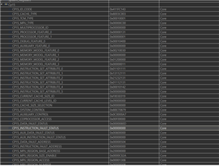

    Can you please check the value of ESM status registers? and CP15 data abort status register?

    Did you use the updated bootloader sys_intvecs.asm?
    resetEntry
    b _c_int00
    undefEntry
    svcEntry
    prefetchEntry
    ldr pc,[pc,#-0x1b0]
    ldr pc,[pc,#-0x1b0]

    In my App I have:
    ESM status
    cp15:

    The value of ESM status registers is zero which means no ESM flag is set.

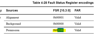

    The data abort fault status is: 0x80D --> MPU permission fault.
    If you run the bootloader only (boot + load the application using CAN or UART + program application to flash (from 0x20020), but don't jump to application), can you get a data abort?
  • Hello QJ Wang,
    Sorry for not expressing myself correctly. When I make the change in the Bootloader program in the sys_intvecs.asm and then load the Bootloader on the board with the CCS, the board stays with the Red LED (17) ON. So, I made the changes you mentioned above except for the _dabort. And it was like:
    ; import reference for interrupt routines
    .ref _c_int00
    .ref _dabort
    .ref phantomInterrupt
    .def resetEntry
    ; interrupt vectors
    resetEntry
    b _c_int00
    undefEntry
    svcEntry
    prefetchEntry
    b _dabort
    b #0x20020 ;phantomInterrupt
    ldr pc,[pc,#-0x1b0]
    ldr pc,[pc,#-0x1b0]

    I ran the Bootloader, and then loaded the Application using CAN (at location 0x20020). If I don't jump to the Application, it doesn't generate the data abort. It only does it when I jump to the Application, and at the part that wants to create the task.

  • You don't need to change the sys_intvec.asm of your application. As mentioned before, the _dabort in your bootloader sys_intvecs.asm should be changed to #0x20020.
    1. _dabort in your sys_intvecs.asm is not changed: the data abort in your application will cause the SW jump to wrong location for abort handler
    2. If you change _dabort to #0x20020, the data abort from your bootloader will not be handled properly. So you need to make sure that there is no data abort happened in your bootloader. Add a breakpoint at a instruction in dabort handler, then run your bootloader to make sure there is no data abort happened.
  • Hello QJ Wang.Sorry for my delay.
    I have a good news. I found the solution!
    I tried with the following vectors:
    ; interrupt vectors
    resetEntry:
        b    _c_int00        ; Reset
        b    #0x20018        ; Undefined instruction
        b    #0x20018        ; Software interrupt (SWI / SVC)
        b    #0x20018        ; Abort (prefetch)
        b    _dabort         ; Abort (data)
        b    #0x20018        ; phantomInterrupt
        ldr  pc,[pc,#-0x1b0] ; IRQ
        ldr  pc,[pc,#-0x1b0] ; FIRQ
    The theory being the offset is always 0x20020 to the same position in the application vector table. And the PC always has instr+8 to begin with.
