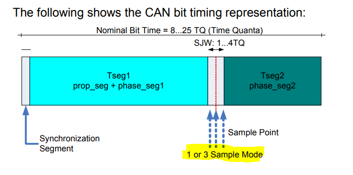

Dear Champs,
My customer's requirement is to use single sample mode for CAN sample mode  - not multiple sampling(Should not use twice or three times sampling... so on ) .
In another words, It should get the sample only once on sampling point where SJW between TSEG1 & TSEG2.
there is no mention about sampling count in the technical reference document, so is AM2634 supported only single sampling point?
I am not asking "sampling position" & timing, I am asking how many samples are collected to determine the signal.
And, can sampling count be adjusted by set some MCAN registers?
