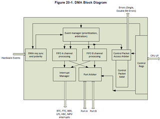

In my project, I'm using 3 DMA channels assigned to 3 UART TX channels. The rest of the DMA channels should be unused. I have a requirement to ensure register writes and I'm doing it following way:
void WriteAndRead(volatile uint32_t* const pReg, const uint32_t value)
    *pReg = ((uint32_t)value);
    volatile uint32_t actualValue = *pReg;
    if ((actualValue & value) != value)
        ErrorRaise(value, actualValue, *pReg, pReg)
With the above code, I'm able to capture errors with really rare occurrence rates and with for example calling parameters ((uint32_t*)0xfff80030, 0xe) and the following error parameters:
1: 0xe,
2: 0x0,
3: 0xe,
4:0xfff80030
So it seems that the CPU is not blocked until the write to Control Packet RAM is finished and the first read operation (param 2) is not returning an expected value. But after a few clock cycles, the correct value is observed (param 3).

  • Hello Jagadish,
    I have some more updates.
    It seems that a timer interrupt triggered during the "Control Packet RAM" reading leads to returning '0' instead of the correct value. With high probability, other interrupts may also affect read operation.
    I made the following steps to reproduce a problem:
    - generate big TX DMA traffic for 3 UARTS (SCI1, SCI3, SCI4)
    - configure 'RTI1 compare interrupt 0' to the atomic increment of a variable.
    - atomic read of this variable before setting value in the "Control Packet RAM"
    - read this variable again when the problem is observed.
    As a result, I'm observing the incrementation of the variable during data write/read. To get reproduction I need sometimes ~20 minutes of test loop. Now I have 6 reproductions - all with the variable incrementation observed but on different RAM addresses. The second data read seems to return always the correct value so I'm expecting problems with the read operation.
    Sebastian
    After further tests, I see that the above problems with interrupts are not a root cause but a source of additional fluctuance between hw and sw.
    What I found out is it is obligatory to use 3 DMA SCI TX channels to reproduce this problem. 2 of them shall be in transmission pending state. According to the below picture, I'm guessing that one is handled by FIFO A, the second by FIFO B and the third is accessing data for configuration purposes using CPU I/F. So we have 3 resources that are trying in parallel to access Control Packet RAM using Control Packet Access Arbiter.
    Could you please verify if from hw perspective such a situation can lead to reading 0 value instead of the correct value on CPU I/F?
