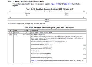

I have code that I use to punch a "P" and "M" value into the SCI BSR registers.
In halgogen, I have SCI3 and SCI2 (LIN2) enabled...not using LIN...using SCI2 as standard uart
I run the code and pass the P and M into the function I have, and point to sciREG2....I see the register load correctly
I run the code and pass the P and M into the function I have, and point to sciREG3....I ONLY SEE THE lower end of the register update!...not the bits 27-24 (M) get loaded..??????
see attached?
what am I missing?...I'm sure it is something stupid simple
