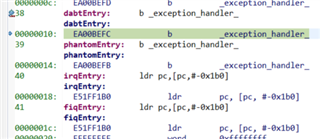

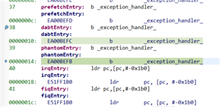

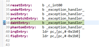

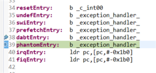

A) Data abort is thrown.
B) Following an "assembly step into" operation, the PC is incremented to the next instruction rather than branching to _exception_handler_.
The documented success/failure cases can be seen below:
