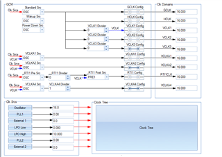

    I use TMS570LS3137 Development Kit and HallCoGen 4.07.00 version do the clock test and I want to use 16Mhz crsytal osilator on the development kit. Here is my HallCoGen configuration:
I use main oscillator for the OSC(don't want to use PLL) clock source, on the development kit, it's a 16MHz crystal. Just, my while loop run the led blink in main.
here my code,

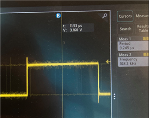

when ı want to measure output of the led with oscilloscope, I observed toggle frequency 108Khz in oscilloscope but I need to observe 16Mhz
But the problem is : watch the OSC frequency, it seems the actual frequency 108Khz, please tell me why.
