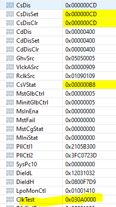

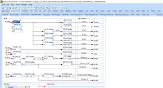

I need to use the clock monitoring during running MCU.
But the function 'void checkClockMonitor(void)' in sys_selftest.c is not working.
It doesn't pass 'Wait till oscillator fail flag is set'
There are similar questions in the TI Forum, but they seem to have not been solved.
(https://e2e.ti.com/support/microcontrollers/arm-based-microcontrollers-group/arm-based-microcontrollers/f/arm-based-microcontrollers-forum/845782/ccs-tms570ls3137-checkclockmonitor-in-sys_selftest-c-from-halcogen---code-freezes-waiting-for-oscillator-to-fail)
(e2e.ti.com/.../oscillator-fault-flag-always-set)

    /* Enable clock monitor range detection circuitry */
    systemREG1->CLKTEST |= 0x03000000U;
    /* Backup register GHVSRC */
    ghvsrc_bk = systemREG1->GHVSRC;
    /* Switch all clock domains to HF LPO */
    systemREG1->GHVSRC = 0x05050005U;
    /* Disable oscillator to cause a oscillator fail */
    systemREG1->CSDISSET = 0x1U;
    /* Wait till oscillator fail flag is set */
    /*SAFETYMCUSW 28 D MR:NA <APPROVED> "Hardware status bit read check" */
    while((systemREG1->GBLSTAT & 0x1U) == 0U)
    } /* Wait */
