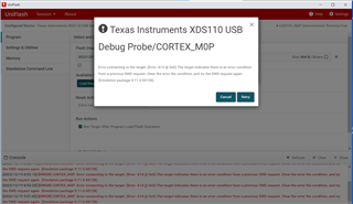

Hi
May I have advice for MSPM0L1304 recoverly?
My customer is developing custom boad on MSPM0L1304.
Question :
Is there any way to recoverly( reset to factory statr or write another program ) in stuation that could not use SWD?
Background:
Now my customer is testing to write binary file using uniflash.
It was succesfully .out, .txt file.
Only After write .hex that generated same project, MSPM0L's SWD will not work.
SWD error message:
Error connecting to the target: (Error -614 @ 0x0) The target indicates there is an error condition from a previous SWD  request. Clear the error the condition, and try the SWD request again. (Emulation package 9.12.0.00150)
I think this mean MSPM0 SWD reject connection.
And we had test BSL entry(PA18 Hi same timing of power up)
But SWD connection was not success.

  • Hi GR,
    It sounds like the customer is either invoking security level 2 (see attached ppt file) or they are disabling the SWD as part of the application code.
    Have the customer check their Sysconfig settings (see slide #2).  Else have the customer provide a copy of their sysconfig file and I can take a look.
    locked SWD.pptx

    And I tested on my EVM(MSPM0L1306), after flash write I could not connect SWD in CCS debug, Uniflash.
    However test connection in CCS target configration was sucess.
    Is there any tool that let MSPM0L factory state, like dbjtag for MSP432?

  • HI GR,
    I received the customers' output file. I don't see anything in the data that would overwrite the Configuration memory.
    Does the customer have access to the BSL and NRST pins on their PCB?  If so, here is a simple procedure from the SDK user's guide FAQ section:
    Recovery Action 3. Force BSL with physical Reset:
    • Press-and-hold the BSL_Invoke button while pressing and releasing the Reset button.
    • The device should go to BSL and stay in Active mode for ~10secs.
    • Attempt to program immediately after releasing reset.
    Regarding a "reset tool", there is a tool that can recover MSPM0L, but it requires the SWD pins be enabled.  Here is link to factory reset tool.
