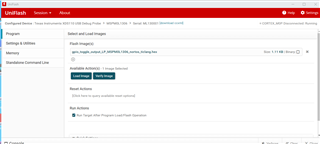

    TI-TXT (.txt) and .out file works nomally. (If write MSPM0L1306 by uniflash, it works)
    But .bin and .hex file that generated conpleatly same project was not works.

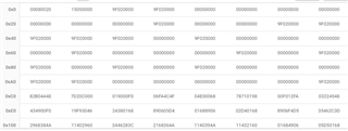

    The data will be correct. But the data mode is wrong. As below, the correct data at 0x0 address should be 0x20000800, but it is 0x800002
    Do you know how to make the change?
  • Please show the first few lines of the Intel hex file.  What does it show is at address 0?  Please copy and paste the text, and do not use a screen shot.

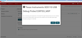

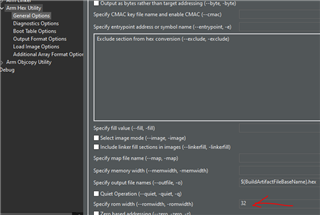

  • Hi George,
    Thanks for your information.

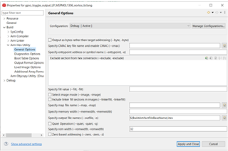

    I tested --romwidth32 option, however generated hex file was incorrect.
    (I tested M0 SDK gpio_toggle_output example)
    first load was sucess, but after try to load, It was not solved the issue.
    This is generated intel .hex file with --romwidth=32 option.
    gpio_toggle_output_LP_MSPM0L1306_nortos_ticlang.zip
    GR

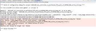

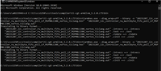

  • The TI-TXT format file and the Intel format file have opposite endianness.  I do not know which endianness is correct, or why.
    Earlier in this thread, Gary Gao attached a CCS project.  I was unable to build it.  I did get to see the build log from that project.  The command used to create the binary file is ...
    "C:/ti/ti_cgt_tiarmclang_3.2.0.LTS/bin/tiarmhex.exe" --diag_wrap=off --binary -o "20231207_i2c_controller_rw_multibyte_fifo_poll_LP_MSPM0L1306_nortos_ticlang.bin"  "20231207_i2c_controller_rw_multibyte_fifo_poll_LP_MSPM0L1306_nortos_ticlang.out"
    Do not use tiarmhex to create a binary file.  Instead, use tiarmobjcopy.  Here is a sample command ...
    tiarmobjcopy -O binary name_of_project.out name_of_project.bin
    Thanks and regards,
    -George

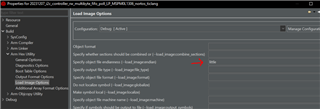

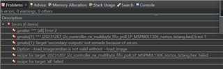

  • I have notice this should be a endianness issue. But when I try to make some endianness configurations below
    It will show the error
    any comments?
  • Don't use the load image options.  They are not related to this problem.
    By George's advice, I tried to  Arm Objcopy Utility. (ARM hex utility is using tiarmhex.exe)
    Result, the generated intel hex file was correct (I could write using Uniflash and It worked as expected.)
    I understand our issue was the probrem on hex generate tool.
    Thank you very much!
    GR

    No,
    I use "arm object Utility" instead of Arm Hex Utility.
    because arm hex utility is using tiarmhex, and arm objcopy utility using tiarmobjcopy.
    GR

    My way is not need command.
    If arm object utility using, the command will be auto generate.
    We could see command by build log.
    GR

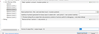

  • Ok, got it. I can also generate the hex file that can work.
    Hi George,
    But it seems hex file is not Intel-hex file, do you know which format of the hex file that generate by the tiarmobjcopy?
  • Hi GR,
    I do not set it, when I add the it, it can generate Intel hex now, great!
