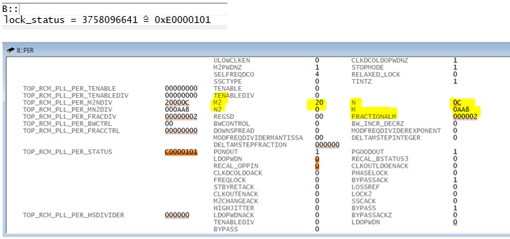

My customer is using MCAL v8.6.2 and faced boot fail issue in high temperature condition(85C Chamber test) and found the AM2634 was stuck as PLL locking was failed as below.
There is no issue when SBL in MCU+SDK was used.
Is there any difference in PLL setting values between MCU init in MCAL and SBL in MCU+SDK?
When customer checked VDD_CPU and clock, they could not find any issue yet. So, we want to check the optimal/Stable PLL value.
Please help on this.

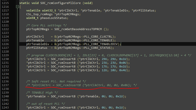

I compared between SBL and MCU_init of MCAL for PLL setting and found only 'soft reset PLL' was deleted in MCU+SDK SBL.
Could you please check if below 'soft reset PLL' should be deleted or not?
In MCU+SDK v8.6.0 and v9.1.0, 'soft reset pll' was deleted as below in SBL.

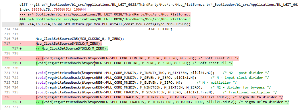

I do see couple of deviations from latest SDK 09.01.00 and 1 bug in PLL lock wait check. Can you try following suggestions?
BR,
Sunil
Hi Sunil,
This solution works!
Could you please clarify what should be modified? Could you please release patch for this?
When I checked Mcu_Platform.c(Mcu_Priv.c) file, there are 2 Mcu_ClockSetSourceSYSCLK(); called. should all these removed?
Should '(void)regWriteReadback(&toprcmREG->PLL_PER_FRACDIV, M_THIRTY_ONE, M_TWENTY_FOUR, pllClk2.sdDiv); /* sigma Delta divider */' be removed? When I checked SBL, I found similar function still existed in SBL as below. So, I would like to have double check with you..

They applied all of 1,2,3 items you suggested as below.
For below suggestion,
They comment as below,
For below suggstion,
3. In do-while loop waiting for PLL to be modified like below as there is a bug.
They modified their code as below.
difference:
modified:
