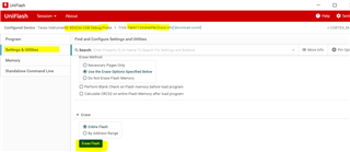

    1. Connect to the TM4C123 through the pogo port as you did earlier by mistake.
    2. Once connected, erase the flash on TM4C123. You can use CCS or Uniflash. I don't know which external debug probe you use. If it is not one of the supported debug probes like XDS110, XDS200 or etc then you can't even continue with the next step. See below screenshot that uses Uniflash to erase the flash on TM4C123.
     3. Go back to my last reply and use the LM flash programmer to update the ICDI firmware.
  • That fixed it for me.  Thank you and I will be more careful next time using my external debugger.
