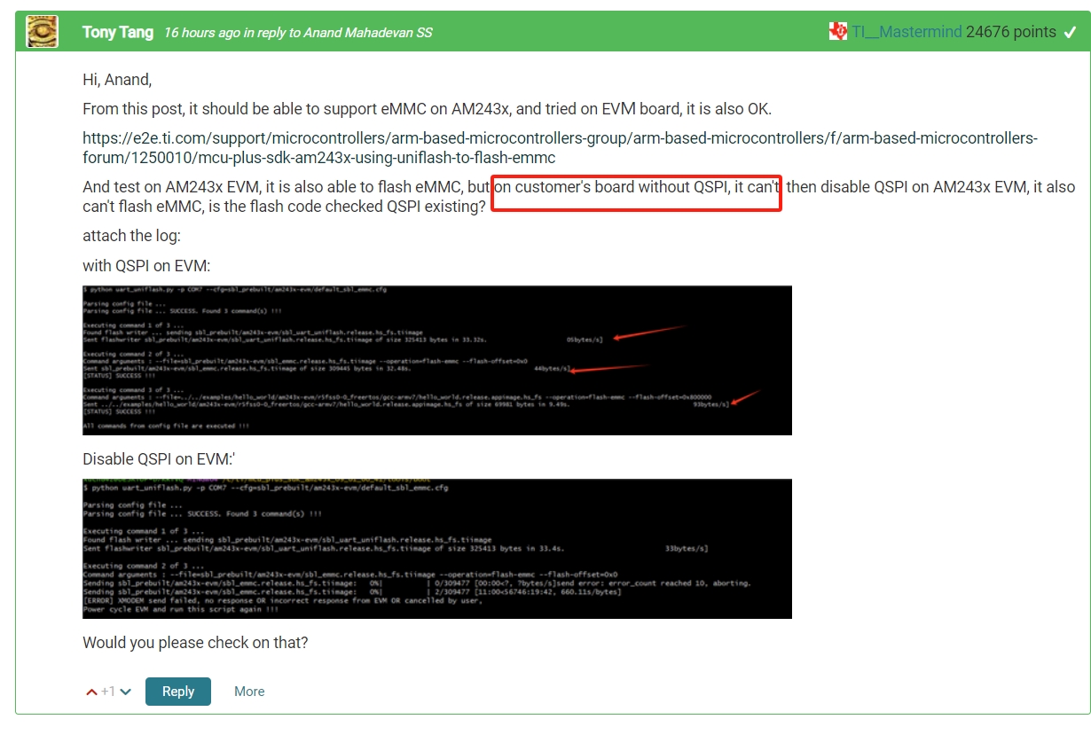

Dear TI experts,
  I am going through the AM243x MCU+ SDK 09.01.00, in Example and Demos ->Secondary Bootloader (SBL)->SBL EMMC, I cannot complete "SBL EMMC".
  I am using  AM243x MCU+ SDK 09.01.00  and  Openssl 1.1.1 .
 1. The following picture is the error when I run the Python command. I don't know why this error exists.
2. I found that the SBL EMMC uses the  AM64x board, and the following is the debugging information from the official website.
3. My doubt is whether sbl_emmc can run successfully on the AM243x-EVM
4. How can I solve this problem?
