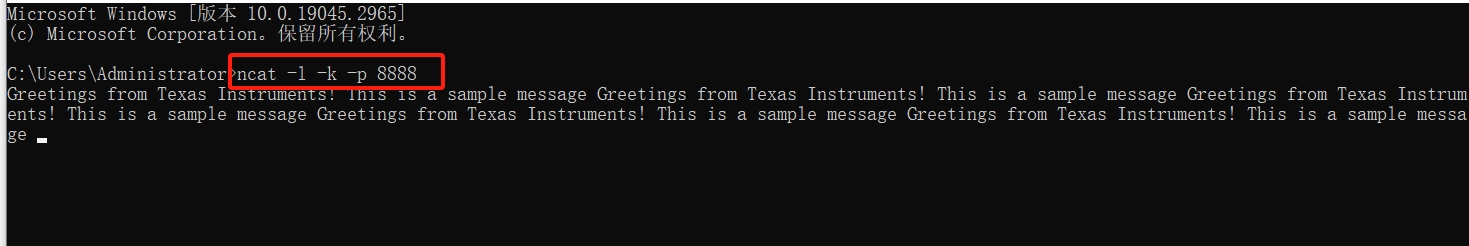

3. Execute "ncat -l -k -p 8888"  command.
4. The results of running "Enet Lwip Socket Example" in my computer.

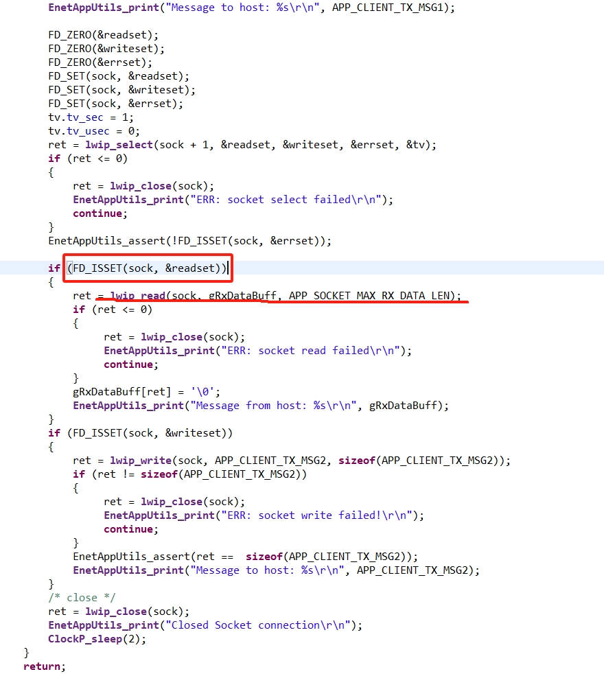

5.  In the app_socket.c -> AppSocket_simpleClient(void* pArg) , I found that FD_ISSET(sock, &readset) has a value of 0, which prevents access to lwip_read(). I tried to solve this problem, but I didn't find the right solution. I don't know if there is some other reason why the data is not being read from host correctly.

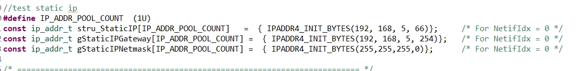

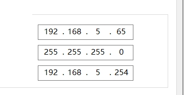

    2.  IPV4 address(PC) is as follows
    3. Client address is as follows
    Weijian Tang

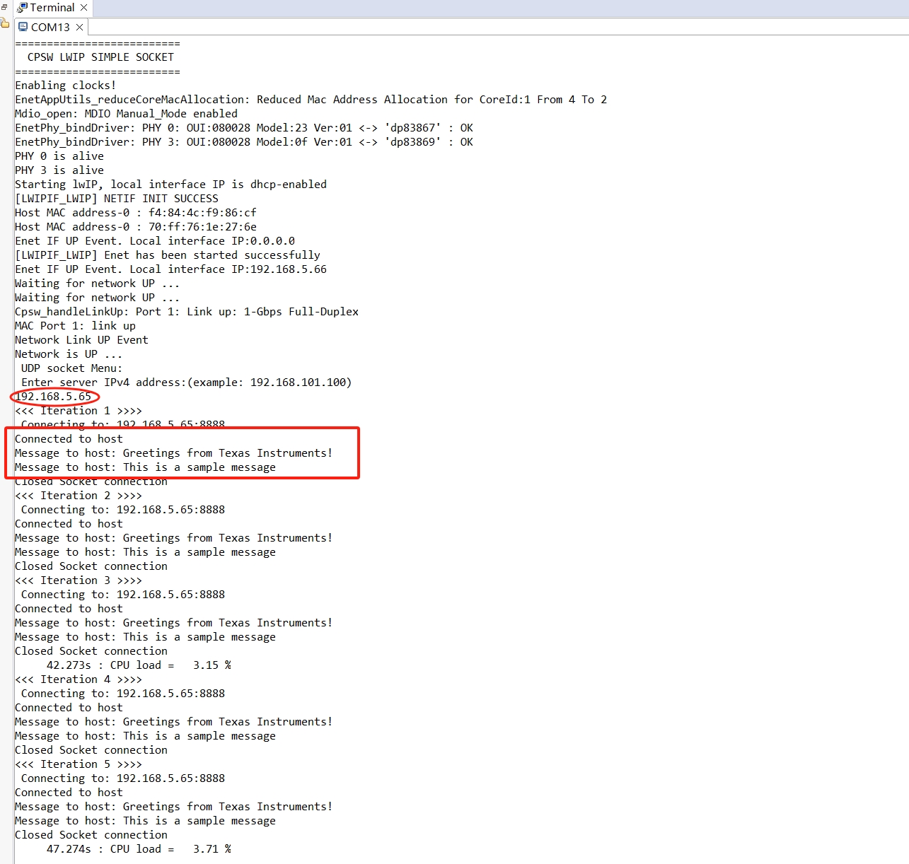

    1. Run NCAT TCP Server with the command "ncat -e /bin/cat -kv -l 8888" (as mentioned in the SDK documentation)
    This will give you the Response from TCP Server in your application (show the message received from host server as displayed in the SDK documentation sample output).
    2. Run NCAT TCP Server with the command "ncat -l -k -p 8888" (as mentioned in your steps above)
    In this case I am able to reproduce the same output as you, i.e. no message received from host.

    Is the command "ncat -e /bin/cat -kv -l 8888" not applicable to Windows10?
    1. I am able to test it on windows,
    2. In case you have access to a Linux machine, you can try that as well.
