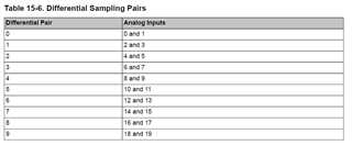

  • Thank you Charles, i see.  One thing i wanted to ask you too is about the possibility of reading single or differential signals. I understand that the range of the ADCs is 0 to VDDA for single type analog inputs and -VDDA to VDDA for differential type analog inputs. From what I have read in the documentation, VDDA is 3.3 V (table 27-44), so could three analog signals ranging from -2 to 2 volts be read (in differential mode) in one of the three modes you have told me about (SS0,SS1 or SS2) right ?
  • If you use differential mode then you can only use SS0 to sample 3 pairs of differential inputs. Three pairs will take up 6 inputs for which only SS0 can support, not SS1 and SS2 which can only take 4 inputs unless you limit to two differential pairs. Refer to the datasheet for details.
    When a sequence step is configured for differential sampling, the input pair to sample must be
    configured in the ADCSSMUXn register. Differential pair 0 samples analog inputs 0 and 1; differential pair 1 samples analog inputs 2 and 3;
    Please refer to the datasheet.
    ■ Input Positive Voltage: VIN+ = VIN_EVEN (even channel)
    ■ Input Negative Voltage: VIN- = VIN_ODD (odd channel)
    The input differential voltage is defined as: VIND = VIN+ - VIN-, therefore:
    ■ If VIND = 0, then the conversion result = 0x800
    ■ If VIND > 0, then the conversion result > 0x800 (range is 0x800–0xFFF)
    ■ If VIND < 0, then the conversion result < 0x800 (range is 0–0x800)
    When using differential sampling, the following definitions are relevant:
    ■ Input Common Mode Voltage: VINCM = (VIN+ + VIN-) / 2
    ■ Reference Positive Voltage: VREFP
    ■ Reference Negative Voltage: VREFN
    ■ Reference Differential Voltage: VREFD = VREFP - VREFN
    ■ Reference Common Mode Voltage: VREFCM = (VREFP + VREFN) / 2
    The following conditions provide optimal results in differential mode:
    ■ Both VIN_EVEN and VIN_ODD must be in the range of (VREFP to VREFN) for a valid conversion
    result
    The maximum possible differential input swing, or the maximum differential range, is: -VREFDto
    +VREFD, so the maximum peak-to-peak input differential signal is (+VREFD - -VREFD) = 2 *
    VREFD= 2 * (VREFP - VREFN)

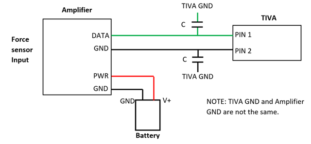

  • I see. I think i understand it. What I am trying to do is something similar to what was asked in this thread.
    https://e2e.ti.com/support/microcontrollers/arm-based-microcontrollers-group/arm-based-microcontrollers/f/arm-based-microcontrollers-forum/787231/tm4c123gh6pm-adc-using-differential-mode-is-noisy
    My idea was like this:
    I understand that this cannot be done because the ADC pins are not designed to read unipolar signals (as it says in the datasheet, "Both VIN_EVEN and VIN_ODD must be in the range of (VREFP to VREFN) for a valid conversion result"). Therefore, the only possible solution is to condition the signal to go from the range -2 to 2 v to 0 to 3.3 v, right ?
  • Therefore, the only possible solution is to condition the signal to go from the range -2 to 2 v to 0 to 3.3 v, right ?
    That is correct.
