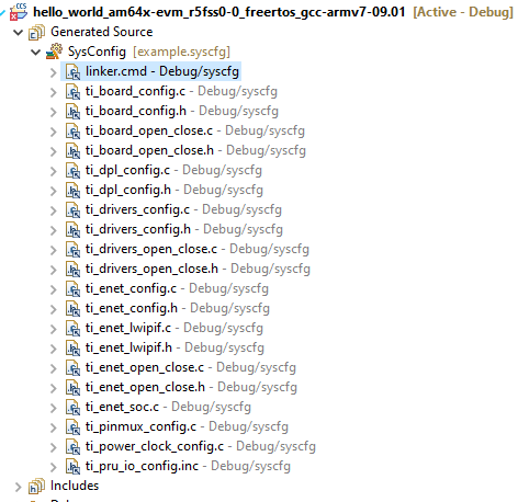

After upgrading to MCU+ SDK for AM64x v09.01.00.41, I was trying to import an example project, in this case hello_world_am64x-evm_r5fss0-0_freertos_gcc-armv7. I have separately installed a recent GCC version (arm-gnu-toolchain-13.2.Rel1-mingw-w64-i686-arm-none-eabi) and try to build the project. The result is a failed build with the following linker error:
makefile:156: recipe for target 'hello_world_am64x-evm_r5fss0-0_freertos_gcc-armv7-09.01.out' failed
C:/ti/arm-gnu-toolchain-13.2.Rel1-mingw-w64-i686-arm-none-eabi/bin/../lib/gcc/arm-none-eabi/13.2.1/../../../../arm-none-eabi/bin/ld.exe:syscfg/linker.cmd:12: syntax error
make was executing the following link command:
Building target: "hello_world_am64x-evm_r5fss0-0_freertos_gcc-armv7-09.01.out"
Invoking: GNU Linker
"C:/ti/arm-gnu-toolchain-13.2.Rel1-mingw-w64-i686-arm-none-eabi/bin/arm-none-eabi-gcc-13.2.1.exe" -mfpu=vfpv3-d16 -DSOC_AM64X -D_DEBUG_=1 -Og -ffunction-sections -fdata-sections -g -gdwarf-3 -gstrict-dwarf -Wall -Werror -Wno-unused-function -Wno-enum-compare -Wno-uninitialized -Wno-int-to-pointer-cast -fgnu89-inline -Wno-pointer-to-int-cast -Wno-unused-variable -Wno-unused-but-set-variable -mcpu=cortex-r5 -Wl,-Map,"hello_world.Debug.map" -static -Wl,--gc-sections -L"C:/ti/mcu_plus_sdk_am64x_09_01_00_41/source/kernel/freertos/lib" -L"C:/ti/mcu_plus_sdk_am64x_09_01_00_41/source/drivers/lib" -L"C:/ti/mcu_plus_sdk_am64x_09_01_00_41/source/board/lib" -L"/lib" -mcpu=cortex-r5 -mfloat-abi=hard -mfpu=vfpv3-d16 -Wl,--build-id=none -o"hello_world_am64x-evm_r5fss0-0_freertos_gcc-armv7-09.01.out" "./syscfg/ti_dpl_config.o" "./syscfg/ti_drivers_config.o" "./syscfg/ti_drivers_open_close.o" "./syscfg/ti_pinmux_config.o" "./syscfg/ti_power_clock_config.o" "./syscfg/ti_board_config.o" "./syscfg/ti_board_open_close.o" "./syscfg/ti_enet_config.o" "./syscfg/ti_enet_open_close.o" "./syscfg/ti_enet_soc.o" "./syscfg/ti_enet_lwipif.o" "./hello_world.o" "./main.o" -Wl,-T"../linker.cmd" -Wl,-T"syscfg/linker.cmd"  -Wl,--start-group -lstdc++ -lgcc -lm -lnosys -l:freertos.am64x.r5f.gcc-armv7.debug.lib -l:drivers.am64x.r5f.gcc-armv7.debug.lib -l:board.am64x.r5f.gcc-armv7.debug.lib -lc -Wl,--end-group

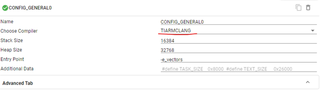

As you may notice above, the linker is invoked with a linker script -T"../linker.cmd", which translates to syscfg/linker.cmd:
Unfortunately, the content of this file is not for GNU, but for TICLANG:

At first I thought, that sysconfig file is per default configured for clang, which is wrong, but it was the case:
Unfortunately, even after changing it to GCC, the problem remains.

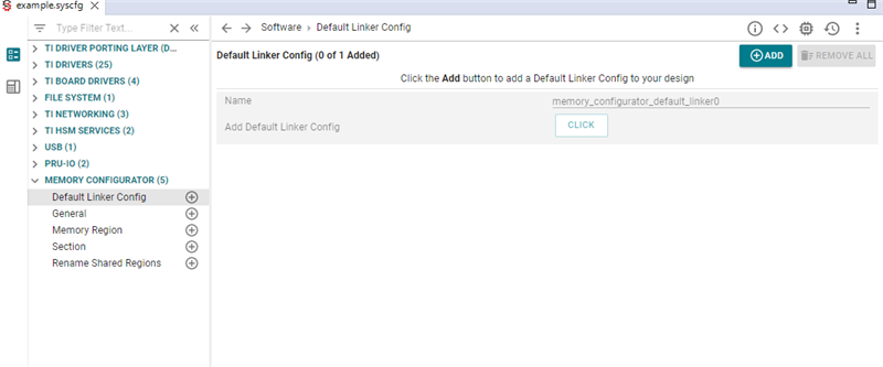

  • Hello Angel,
    Thanks for your patience.
    To remove the above error, please follow the below steps:
    • Open the example.syscfg file.
    • Remove all the sections related to Memory Configurator. Please refer below screenshot.
    • Build the GCC libraries.
    To build the libraries, please run the below commands from root of ${MCU+SDK path}.
    cd ${MCU+SDK install path}
    gmake -f makefile.am64x libs_gcc PROFILE=debug
    gmake -f makefile.am64x libs_gcc PROFILE=release
    Rebuild the example with above settings. The example will now build without any errors.
    The problem here is because of the linker.cmd file generated by Sysconfig Memory Configurator tool. The linker configuration if made from sysconfig, ccs will try to pick that up. The memory configurator tool doesn't support gcc linkers and there's no plan to do so yet.
    To By-pass sysconfig generated linker configuration, please refer MEMORY_CONFIGURATOR.
    Please let me know if the above solution works.
