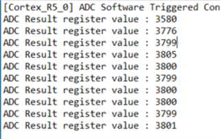

Hello Team,
I have tested adc_soc_software project in the MCU PLUS SDK folder. While measuring i can see the difference of more than 0.3v with voltage given and teh vaue printed in the software.
Voltage Given(in volts) ADC Result printed in the software Difference between printed value and given voltage(In volts)
3.073  0.18
2.684  0.3
2.747  0.325
2.264  0.803
Is there any error percentage tolerance? What could be the reason for this much difference?

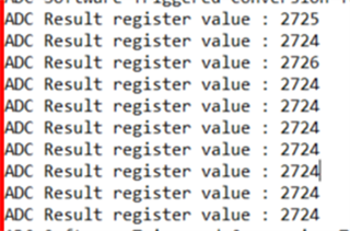

    Sorry I have checked wrong pin. I captured the values using correct pin (ADC 0 Channel 2, which on the HSEC dock, is present on pin 12 for AM263x CC E1 revision).
    Please find the details below.
    adc_soc_software
    ADCVOLTREF 3.3v
    Resolution  4095
    Voltage Given Calculated ADC Count Value Value Printed from Software
    2.29 2841.6818
    2.155 2674.159091
    1.889 2344.077273
    1.373
    1703.768182
    Calculated ADC count using the equation = (4095/3.3) *Voltage given.
    Could you please confirm the difference between calculated ADC count and the value printed in the software?
    Thanks in advance
    Aswathy J G

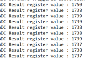

  • Hi Aswathy,
    Thanks for confirming. ADC input range is from 0v-3.2v for codes 0v-4095v. and hence the conversion formula is adc_code = (vin*4096/3.2). yet, the codes in your shared table are almost 30 LSB away. this too high of an error, than what is mentioned in the datasheet. the common scenario is when the Signal source has higher impedence. looping in HW expert for better results. meanwhile, could you please try the following,
    1. Try a lower impedence source and see if there is improvement in the codes.
    2. Are there spikes in the input when the ADC is sampling. (please check with a high BW oscilloscope.)
    3. Try increasing the Sample and Hold window and see if there is any improvement over codes
    Thanks and regards,
    Madhava

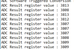

  • Hello Randy,
    I have checked with oscilloscope and there were no noises seen.
    I have measured the ADC counts with External reference. and which is connected as per below thread.
    (+) AM2634: Usage of external ADC reference voltage - Arm-based microcontrollers forum - Arm-based microcontrollers - TI E2E support forums
    Observations:
    1. When number of channels increased the difference in ADC Count also increases.
    2. Difference in ADC count is more in low and high extreme values. Seems to be normal in middle range.
    Please find the attached sheet for more details.
    ADCMeasurement_ExtADCREF.xlsx
    Have you tried with max number of channels in each ADC unit?
    Could you please confirm this behavior and please provide your feedback.
    Thanks and Regards
    Aswathy J G
