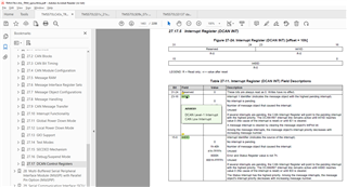

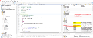

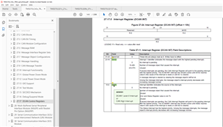

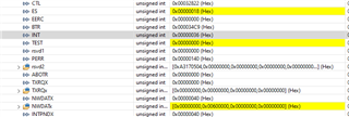

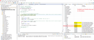

When I want to use low level interrupt for receive message from can bus i got this issue. Here canREG1->INT value equal to 0x036 but if i try with halcogen output i encountered 0xD800000 which equal to 36 shifted by 16. I checked my code many times but i couldnt see any hint to solve.
here my first assigments to INTMUXx[0] and INTMUXx[1]
after that i enabled 55 message box as rx. I shifted related part of register according to message box number. Shift operations shown below.
