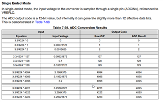

In TRM,
Based on a given ADC raw output, ideal equation for calculating ADC input is,
ADCin = (Vref/4096) * ADCResult .
But in the table provided in the TRM, uses another equation.
as ADCin = (3.3/4224) * ADCResult.
Please check below image.
I have calculated ADC count using, ADCin = (3.3/4224) * ADCResult. formula. please check below table
Multimeter value in Voltage Expected ADC Count ADC Count form SDK software. Difference in ADC count
2.815 3603.2 3570 33.2
2.131 2727.68 2696 31.68
1.889 2417.92 2392 25.92
1.494 1912.32 1894 18.32
1.159 1483.52 1483 0.52
0.101 129.28 133 -3.72
Could you please confirm?
1. The 4224-value used in this equation and which equation is valid for our use?
2. The difference in count between calculated value and value from software.?
