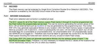

I'm trying to understand ECC and SECDED on tms570lc4357 devices.
 https://e2e.ti.com/support/microcontrollers/arm-based-microcontrollers-group/arm-based-microcontrollers/f/arm-based-microcontrollers-forum/555172/how-ecc-works-on-tms570lc43x-ram-flash-and-other-locations
In this link above there is a clear explanation about L2RAMW. I understood that there is a SECDED mechanisim on L2RAMW ECC calculation on CPU and after that there is another ECC calculation on L2RAMW. Is my understood is true ?

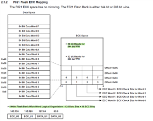

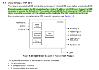

Do these operations occur in the same way on Flash? Is an ECC calculation made on the flash wrapper too or is only the data obtained from the CPU used? In SPNA148 there are sections about flash wrapper and ram wrapper.
But I couldn't understand clearly flash operations. Can someone explain clearly ECC calculation on flash ?
