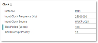

We need a 100us OS tick for our FreeRTOS implementation using the Clock configuration in SYSCONFIG. I see the default WUCPUCLK (25MHz on the EVM) is used for all the examples I've opened so far.
1) My understanding then is that we can generate the 100us tick with a resolution of 40ns (1 / 25MHz). Have I understood that correctly please? If so, this sounds plenty good enough to me.
2) Is there any merit to choosing a different clock source (e.g. DPLL_PER_HSDIV0_CLKOUT1) with a higher frequency to generate our 100us tick apart from the obvious higher resolution?
Thank you.
  • Hello Kier,
    1) Your understanding here is correct.
    2) Routing a higher frequency clock through the SoC will result in a higher power consumption. It is recommended to use the default frequencies whenever possible as this will provide the most accurate HW implementation of the configuration provided in the Power Estimation Tool.

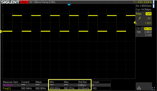

  • Just for the completeness, I compared some of the clock sources for stability using a toggling GPIO pin from a 1ms FreeRTOS task.
    RTI0 Clock Core0_1ms GPIO Toggle Frequency (Hz)
    Source Source Freq Min. Max. Std Dev
    WUCPUCLK 25MHz 495.87 508.4 1.31
    DPLL_PER_HSDIV0_CLKOUT1 192MHz 499.93 500.07 0.02
    DPLL_CORE_HSDIV0_CLKOUT1 500Mhz 499.95 500.06 0.02
    XTALCLK 25MHz 499.69 500.37 0.06
    SYS_CLK 200MHz 499.93 500.08 0.02
    For reasons unknown, the WUCPUCLK performs much worse than XTALCLK*. Given the power consumption argument above, the best option seems to be XTALCLK rather than WUCPUCLK.
    Here's the scope screenshot for XTALCLK result above
    *Any idea why this might be Zackary?

  • Thanks for the response.
    What was the methodology and timespan
    I allowed the scope to take approx 100 samples. I think it samples once per second so that is ~1m 40s. I don't have any other info on how the scope makes the statistical calculation.

  • OK, I tried to replicate the problem with a project based on FreeRTOS blinky but could not see the issue. I guess there must be some other factors at play. Let's close this I think. Thanks for following up anyway.
  • Sounds good! Thanks Kier. My initial thoughts go to the test setup, if different probes or cables were used, any difference in the active load experienced by the pin during measurement would create a low-pass filter and impact the rise/fall rates of the signal and lead to the delta found previously. Please feel free to reach back out if any further questions arise.
