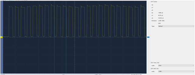

I'm trying to optimize the SPI timing and my goal is to have a continuous clock frame without any pause between bytes.
I use  EK-TM4C1294XL to do my tests.
The SSI is configured as a master by using the following function:
    SSIConfigSetExpClk(SSI0_BASE, 120000000, SSI_FRF_MOTO_MODE_0, SSI_MODE_MASTER, 1000000, 8);
My component need the SSI_FRF_MOTO_MODE_0 (Idle clock low and capture on first edge of clock)
I use SSI0 and it is configured at 1MHz clock.
To test it after configuration I write to SPI FIFO 4 bytes to be sure to not have any pause between bytes:
HWREG(SPI0_BASE + SSI_O_DR) = 0;

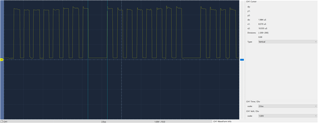

I have a scope plugged on the CLK pin to observe byte stream:
As you can see on the capture, there is a one clock pause between each bytes.
However If I change the format to SSI_FRF_MOTO_MODE_1 or  SSI_FRF_MOTO_MODE_3 then there is no pause between every bytes:
After discovering this I tryed all the mode and it seem that when Phase is 1, then there is a pause of one SPI clock between every bytes:
To resume:
  • SSI_FRF_MOTO_MODE_0 and  SSI_FRF_MOTO_MODE_2 have a pause between each bytes
  • SSI_FRF_MOTO_MODE_1 and  SSI_FRF_MOTO_MODE_3 DO NOT have a pause between each bytes
