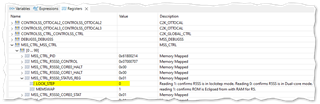

Since CCS12.5, the following advice (rather its reverse) in C:/ti/mcu_plus_sdk_am263x_09_01_00_41/docs/api_guide_am263x/CCS_LAUNCH_PAGE.html doesn't work:
Using a simple SDK empty project, if I set 'mode = 0;' the console output suggests it is configuring for lockstep:
Cortex_R5_0: GEL Output: Loading Gel Files on R5F0
Cortex_R5_0: GEL Output: Gel files loading on R5F0 Complete
Cortex_R5_0: GEL Output: ***OnTargetConnect() Launched***
Cortex_R5_0: GEL Output: AM263x Initialization Scripts Launched.
Please Wait...
Cortex_R5_0: GEL Output: AM263x_Cryst_Clock_Loss_Status() Launched
Cortex_R5_0: GEL Output: Crystal Clock present
Cortex_R5_0: GEL Output: AM263x_SOP_Mode() Launched
Cortex_R5_0: GEL Output: SOP MODE = 0x0000000B
 Dev boot mode
Cortex_R5_0: GEL Output: AM263x_Read_Device_Type() Launched
Cortex_R5_0: GEL Output: EFuse Device Type Value = 0x000000AA
Cortex_R5_0: GEL Output: AM263x_Check_supported_mode() Launched
 mode = 0
Cortex_R5_0: GEL Output: MSS_CTRL Control Registers Unlocked
Cortex_R5_0: GEL Output: MSS_TOP_RCM Control Registers Unlocked
Cortex_R5_0: GEL Output: MSS_RCM Control Registers Unlocked
Cortex_R5_0: GEL Output: MSS_IOMUX Control Registers Unlocked
Cortex_R5_0: GEL Output: TOP_CTRL Control Registers Unlocked
***R5FSS0 Reset for Lockstep ***
*** R5FSS1 Reset for Lockstep ***
Cortex_R5_0: GEL Output: R5F ROM Eclipse
Cortex_R5_0: GEL Output: R5FSS0_0 Released
Cortex_R5_0: GEL Output: R5FSS0_1 Released
Cortex_R5_0: GEL Output: R5FSS1_0 Released
Cortex_R5_0: GEL Output: R5FSS1_1 Released
 All R5F Cores Released for program load
Cortex_R5_0: GEL Output: L2 Mem Init Complete
Cortex_R5_0: GEL Output: MailBox Mem Init Complete
Cortex_R5_0: GEL Output: *********** R5FSS0/1 Lockstep mode Configured********
Cortex_R5_0: GEL Output: CORE PLL Configuration Complete
Cortex_R5_0: GEL Output: PER PLL Configuration Complete
Cortex_R5_0: GEL Output: SYS_CLK DIVBY2
Cortex_R5_0: GEL Output: DPLL_CORE_HSDIV0_CLKOUT0 selected as CLK source for R5FSS & SYS CLKs
 CLK Programmed R5F=400MHz and SYS_CLK=200MHz
 *** Enabling Peripheral Clocks ***
Cortex_R5_0: GEL Output: Enabling RTI[0:3] Clocks
Cortex_R5_0: GEL Output: Enabling RTI_WDT[0:3] Clocks
Cortex_R5_0: GEL Output: Enabling UART[0:5]/LIN[0:5] Clocks
Cortex_R5_0: GEL Output: Enabling QSPI Clocks
Cortex_R5_0: GEL Output: Enabling I2C Clocks
Cortex_R5_0: GEL Output: Enabling TRACE Clocks
Cortex_R5_0: GEL Output: Enabling MCAN[0:3] Clocks
Cortex_R5_0: GEL Output: Enabling GPMC Clocks
Cortex_R5_0: GEL Output: Enabling ELM Clocks
Cortex_R5_0: GEL Output: Enabling MMCSD Clocks
Cortex_R5_0: GEL Output: Enabling MCSPI[0:4] Clocks
Cortex_R5_0: GEL Output: Enabling CONTROLSS Clocks
Cortex_R5_0: GEL Output: Enabling CPTS Clocks
Cortex_R5_0: GEL Output: Enabling RGMI[5,50,250] Clocks
Cortex_R5_0: GEL Output: Enabling XTAL_TEMPSENSE_32K Clocks
Cortex_R5_0: GEL Output: Enabling XTAL_MMC_32K Clocks
 ***All IP Clocks are Enabled***
Cortex_R5_0: AM263x
However, a quick check of the status reg and it is not in lock step, it is in dual core mode:
Please confirm.
