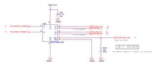

    Could this be why the example code doesn't reference the FSI/EPWM2 MUX pin? I can't currently run it and problem the PWM output to check if it runs on the Launchpad, but the documentation very clearly references a MUX with the FSI header and it did enable me to get some output on the pins, even if not quite right:

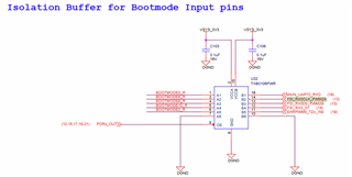

    Assuming I'm on the right track, what's the significance of the EPWM2_A and EPWM2_B pins connecting to this boot mode isolator mentioned in PROC109E3_SCH? Could it be something I need to consider to allow the signals to pass through uninterrupted?
    More strangely this document says AM2434 ball U18 and U20 are connected via the bootmode isolation buffer and FSI mux to EPWM2_A and B respectively. Which appears to add weight to the example EPWM sync Sysconfig being the correct configuration, as ALV. The same document does state that it's an ALX chip being referenced:

    With respect to Bootmode Isolator, this is typically used to isolate boot mode pins of the SoC which have an associated alternate function during normal operation.

    In EVM, EPWM2 signals are going to HSE or FSI connector there also we have FSI/HSE mux selection line which is controlling either from SOC GPIO and Resistor connected. So, by default this selection pin is connected to Ground through the Resistor. So, EPWM2 pins are selected without controlling any GPIO signal from the SOC. So, this pin configuration is not available in the EVM example to use EPWM2 module.
    Coming to the LP module, again these EPW2 pins are linked with the FSI pins and mentioned by you, after controlling the GPIo0_26 pin as high, as we can drive the EPWM2 signals and again these pins are sharing in between BOOTMODE pins. So, on the side you are driving your PWM signals and another side boot mode it will drive another signals due to this you are not able to drive properly.
    You can try BOOTMODE 8 and BOOT MODE 9 pins as high in your application side for only Testing purpose .
    We don't recommended this procedure but sharing method for Testing purpose .
    You need to control BOOTMODES accordingly to your requirement , otherwise SOC does not enter into proper boot mode.

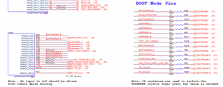

    I thought that the isolation buffer being a TXB0106PWR in E3 meant that after boot, these balls are still accessible, no? If the balls used for these boot mode signals cannot be accessed reliably by the booster pack pins after boot, what's the significance of having them connected to the booster pack pins at all?
    We've created a comprehensive boosterpack system that relies on 6 EWPM signals. Eventually, we'll do away with the LP altogether but for now, we want to avoid doing PCB layout for the whole AM2434 chip, and I need to find a way to make this work.
    I can't test at this very moment, but I am developing with QSPI boot mode which means BOOTMODE 8 is high and 9 is low, which could explain why EPWM2_A works more than 2_B?
    Where can I find information on how BOOTMODE signals 3-9 are used? I'd like to understand the significance of shifting 8 and 9 to HIGH permanently because it sounds like we need to do this beyond testing, or I need to find a way to switch them HIGH after boot so I can access EPWM2_A and EPWM2_B on the LP without issue.
  • Is this the table I'm looking for?
    Does this mean if I use No Boot, I'm free to set BOOTMODE 8 and 9 to whichever state? But I won't be able to use QSPI boot because we need Iclk to be set?
