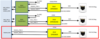

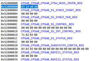

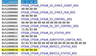

I have an issue with Ethernet transmission, MCAL Eth demo is working.
From my configuration Eth frames are receiving but no transmission.

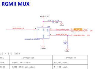

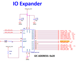

Q1) Do i need to control MUX via I2C IO Expander?
RGMII_MUX_SEL signal in controlled by IO Expander
In Eth demo  IO Expander is configured via I2C_2 channel.
I have not configured I2C in my configuration, still i can able to receive Eth frames.
When i configured I2C & MUX, frames are not receiving at all..
Q2) Which is J7(Eth connection 1) in below image?
