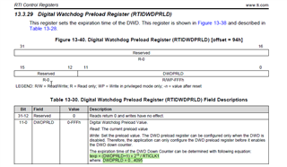

  • Hi IBLEE,
    The maximum preload value is 4095 only not 65535.
    But this value will gets left shifted by 13 bits. And expiration time formula is given above.
    If your RTI clock 75Mhz and Preload value 4095 then expiration time will be: 0.447 Seconds, if this expiration time will not be sufficient in your application then you should need to decrease the RTI clock to increase the expiration time further.

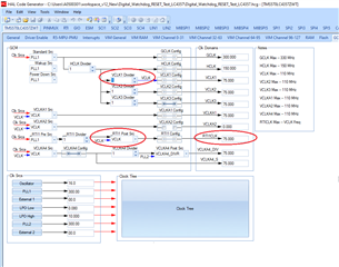

  • Dear Jagadish
    thank you so much.
    It's my first time using Ti products, and it's my first time with Halcogen, so I'm sorry I don't know much about it.
    Let me ask you one more question.
    RTI1CLK is set to 90 in Halcogen, but I cannot change this value.
    Can you tell me one more time what to do?
    IBLEE
  • Hi IBLEE,
    No problem, we will assist you anytime.
    Verify which source was connected at "RTI1 Post Src", if it is VCLK means the clock is driven by VCLK1, so to reduce the clock we have to increase the "VCLK1 Divider".
