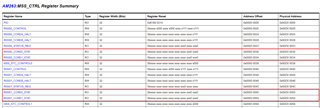

AM2634: Cores unhalt issue when there is no wait after updating the register.
Part Number: AM2634
From the SDK I see Bootloader_runCpu API is doing the unhalt process, is there any register to check the status of the CPU to make sure it has started?
I see removing extra unneeded code like Bootloader_socCpuRelease and Bootloader_socGetCoreName makes some issues and the core does not start properly without adding a delay after unhalt process.
Could you please guide me on this?
I can see these extra APIs calls are working the same as a delay so how to check the have started correctly(register or flag)?
