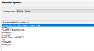

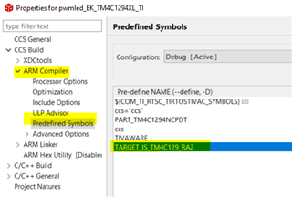

    2. Add the TARGET_IS_TM4C129_RA2 symbol.
    3. Call something like below.
    ROM_PWMClockSet(PWM0_BASE, PWM_SYSCLK_DIV_8);  // Sysclk divide by 8.
  • Hello Charles,
    I actually had it implemented, only missing headers:
    #include <stdbool.h>
    #include "inc/hw_memmap.h"
    Also, I had defined TARGET_IS_TM4C129_RA0. Which is correct for TM4C129ENCPDT?
    After the changes the result is the same. The code compiles fine, runs to the breakpoint at ROM_PWMClockSet and when I step over it aborts. Here is the calling stack:
    Any ideas?

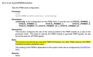

  • SysCtlPWMClockSet(SYSCTL_PWMDIV_64);
    clock = SysCtlPWMClockGet(); => Always get 0

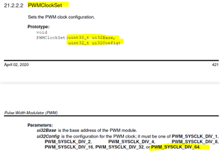

      You should not use SysCtlPWMClockSet() for TM4C129 device. This API is only for TM4C123. You should be using PWMClockSet() instead for TM4C129.

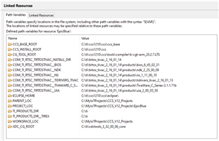

    Unfortunately, when executing the PWMClockSet it errors out and aborts. I must have some configuration issue. Using
    and
    Is my configuration correct? Also please point me to the documentation you have made the screenshot from.
    Thank you,
    Dalibor
  • Hi Dalibor,
      I was referring to the TivaWare Peripheral Driver Library user's guide. You can also find it in the TivaWare SDK installation under the /docs directory.
